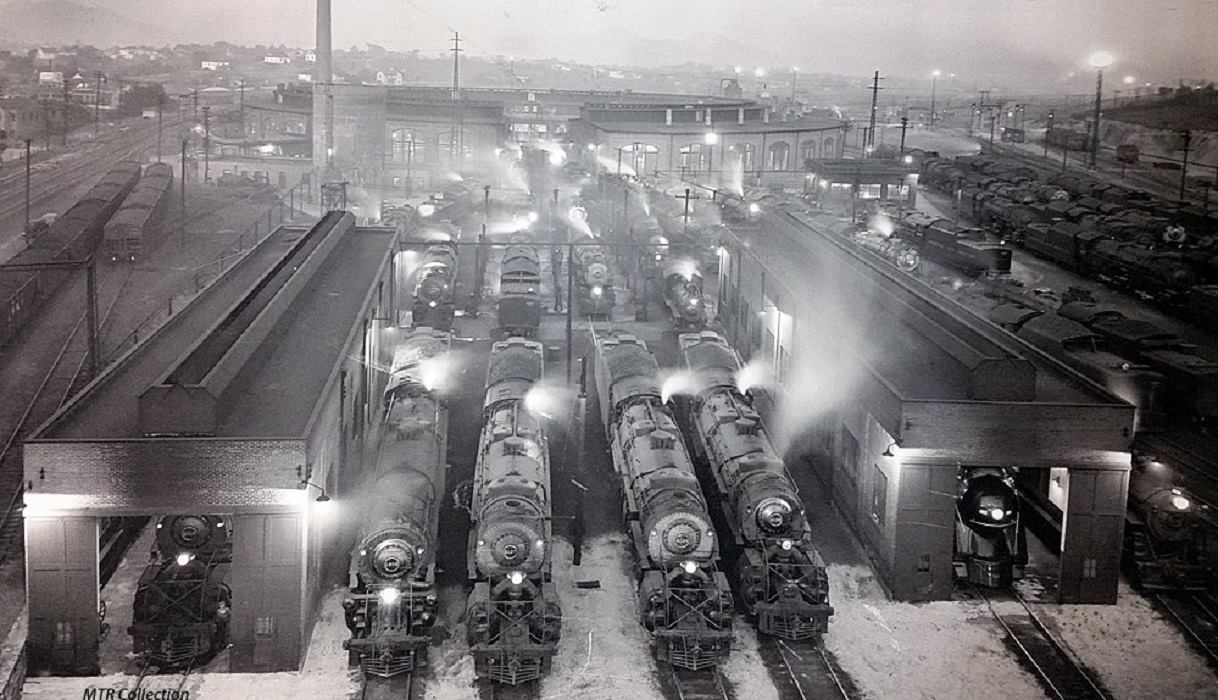

N&W’s Shaffer’s Crossing
Roanoke, Virginia
The two buildings in the foreground are “Lubritoriums”.
