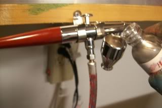

For my metalizing work I’ve been using the Paasche’ VL. Instead of the bottle, I now use the chrome cups, which are so easy to clean. I use two units: one only for the Alclad metalizer, the other for paint and clear coats. My first VL lasted me 20 years but I dropped recently on concrete (for the 3rd time!) and it was beyond repairs.
This VL is the one I use for metalizing:
In this photo, the VL with the orange-red handle was my older unit, which is the one I just retired.
I recently purchased a new VL (by itself, no accessories) for $80, it’s hard to beat. If you don’t mind spending a bit more, the new TG-set is an impressive gravity feed unit.
