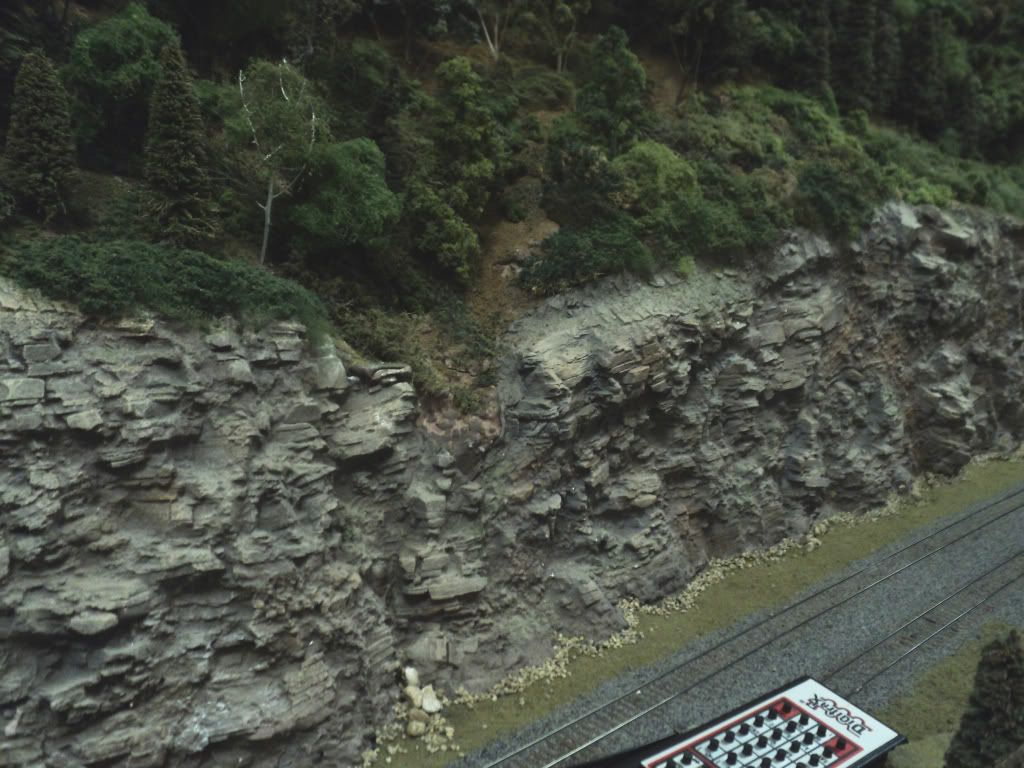

That said, if this stuff is conglomerate, just having a coating of Sculptamold might work really well to represent it. That’s what I did on the background here on these.
The Cripplebush rocks take acrylics readily. I did not bother to prime mine, but just did my thing straight on. All the cliffs in between the front and upper back levels here are Cripplebush Rocks done that way. They’re great for liftouts, which these happen to do. This one is about 6’ long.
Ink vs acrylic black wash? I’ve found acrylics easier to deal with, except on wood. I generally spray/mist it on, so take that into consideration if you use a brush.
The Cripplebush “rubber rock” is quick base painted a very dark gray, some brownish highlights. I found rattle can spraying of the molds w/ various Krylon acylics to work best to start to get close to “my” rock/ shale (reddish/ brown) In your case you will be needing tans, reds, rust and variations of light brown. I sprayed the molds prior to placing, darker shading sprayed from “low” below and lighter coloring from above. This was only to get a close base color as the final drybrushing of highlights and shading was done after satisfied w/ the installation and blending into surrounding terrain.

Paul,
I used Sculptamold. Places where I wanted it to stick to the Cripplebush rocks, I just slapped it on and it sticks well. Places where I wanted it as fill, but not stuck to the CBush rocks, I placed plastic wrap between them and the Sculptamold. Here some pics that show it a little better. I use styrofoam underneath as the base/armature to apply the Sculptamold and rubber rocks to.
