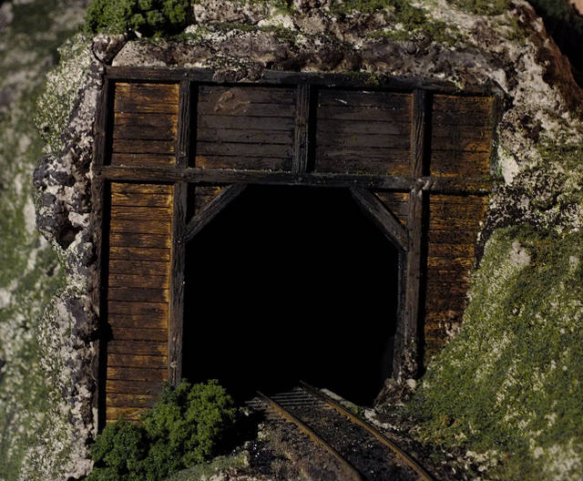

I have a couple of the Woodland Scenics ‘wooden’ tunnel portals, I think they’re made of a material like light weight hydrocal. How would you go about painting these? I’m thinking I should spray paint them with a gray primer color and then… hmmmm… paint each ‘timber’ separately using maybe a gray-ish brown water based paint.

Hi Jarrell: I think I painted mine roof brown, originally, but then painted it gray, with an ink/alcohol wash. DJ.
I vote for no primer and a very dillute grey/black wash. Apply as many coats as requires to get the color you want.
Thanks Grampy for the picture, that’s just about the look I’m after. I like your ‘granite’ looking rocks too, what colors/technique did you use for them. I think this is one of your best pictures!

Jarrell, I’ll have to scout around for a photo of mine, but I just mixed some Burnt Umber and black and slopped on a heavy wash, maybe in two goes…it has been five years and I can’t recall how I did it exactly. Once it was in place, I used a dry brush black to create the sooty smear above the apex of the portal, and a bit down the inside faces since some smoke would be deposited there as well as the engine exits the portal and smoke billows all around the smokebox and boiler.

Edit - I took this one just now. It’s hand-held with the new camera, Jarrell. [:D]
Thanks, Jarrell. Well, I sprayed the white castings with India ink/alcohol mix. Let it dry. Then a thin wash of earth color and before it dried, another spray of ink/alcohol. Repeat, if necessary, till I got the color I wanted. Finally, dry brush with light gray paint. DJ.

I did something similar to Crandell with my timber portals, only used a flat reddish-brown primer to start with. Then I went over it with Raw Umber and black at the apex to simulate all that nasty Utah coal-smoke coming from my articulateds, LOL!
