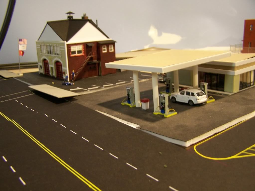

I did these with a white gel pen from a craft store:
