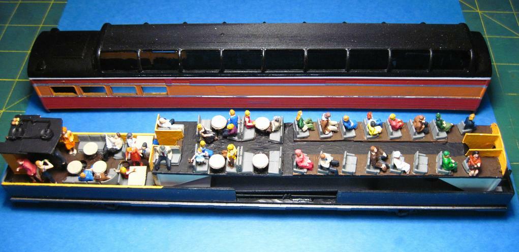

I’m a cheapskate and build up my interiors.
Chairs are Mel castings.
Chairs are from Shapeways.
Mel mold of a IHC interior, casting is from the mold. I cut up the castings.
Precision Scale passenger seats, made molds of those too.
Chairs are Mel castings, figures too.
More Mel castings.
I’ve done a total of 27 passenger car interiors, it’s a blast!
