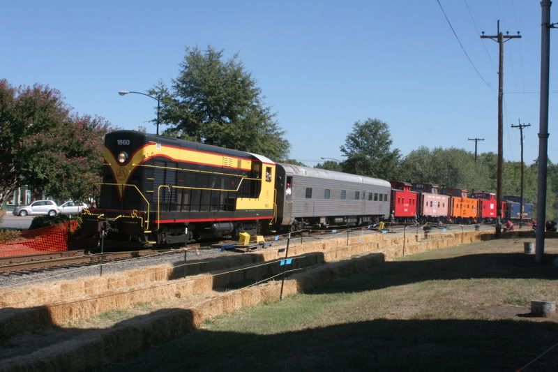

OK OK … I am familiar with ONE passenger train that runs a caboose.
It’s the Caboose Train at the North Carolina Transportation Museum.
