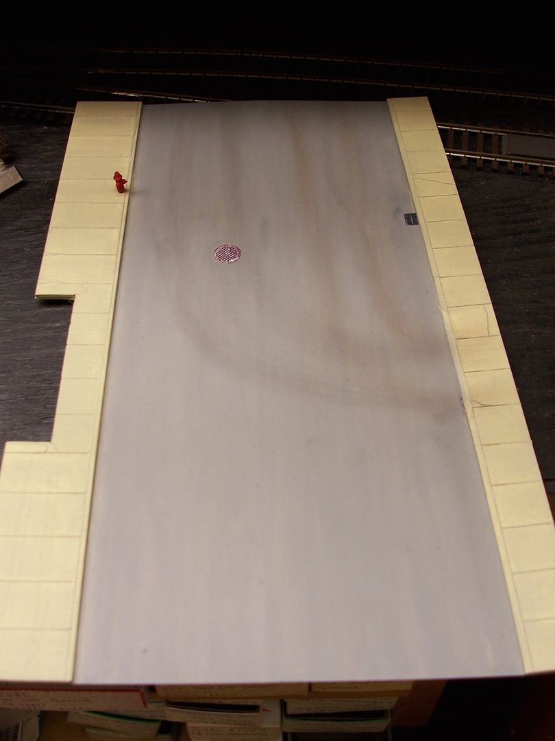

I also do a lot of roads using sheet styrene, and for a couple streets on the upper level of the layout, I simply pre-fabbed them to fit around structures that were already in place…
The sidewalks are .060" styrene sheet, while the roadway is only .030" thick, so I added a strip of .030" or .040" thick styrene under the centre of the pavement, to create a crown in the road.
