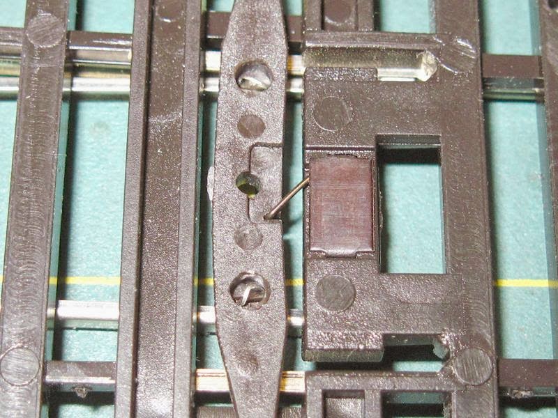

I have a close up shot of a Peco turnout if that would help.
I modified several Atlas turnouts to have the Peco type spring, I used this picture to do my mod.

The first photo in Mel’s reply is very helpful. It shows the Peco turnout upside down. The trick is to return the turnout to its normal position, right side up, without having the spring fall out. The challenge is to get both legs of the spring in place without having the spring go flying.
Here is what I do. I begin by placing the left leg of the spring into the hole provided in the throwbar. Then, with my left hand holding the left leg of the spring in place with a small hobby screw driver, I grasp the right leg of the spring with a pair of tweezers in my right hand and insert it in the hole provided on the underside of the tie. With the spring now held firmly in place, I insert that metal tab over the right leg of the spring and flip the turnout over so that the two legs of the metal tab can be bent back into place to complete the installation.
