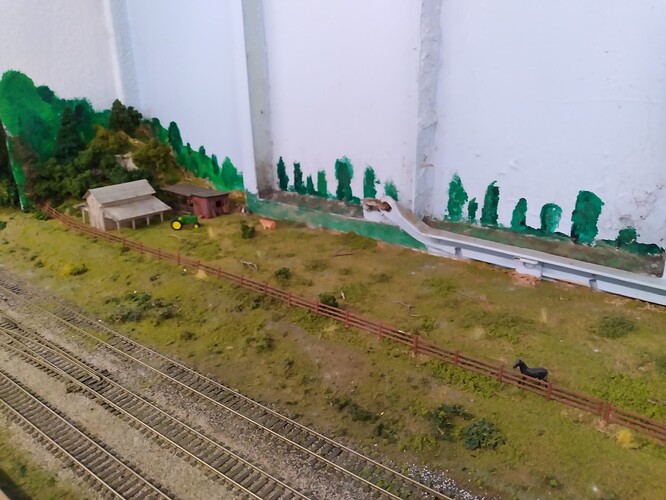

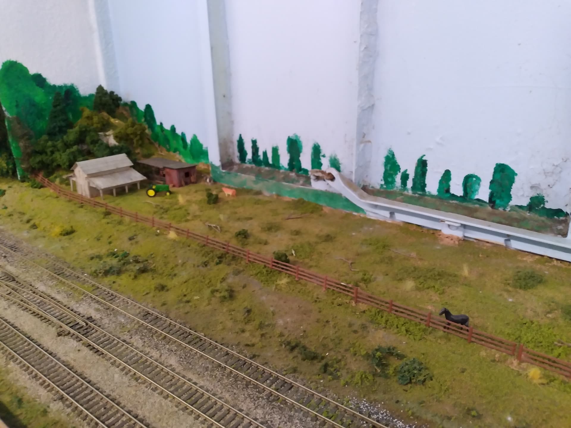

You can mix it with cheap craft paint to give it color. Everything you see here is PermaScene except the water. At normal viewing distance, those pinholes aren’t noticeable.
Wider view, early experimentation with water color.
Experiment with paint washes
