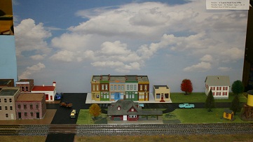

For my children’s Youth in Model Railroading city module we just glued a photo of clouds to 1/8" masonite. Actually the clouds are smooshed vertically, but since they are clouds it is impossible to tell.
Those are nice clouds. ROAR
