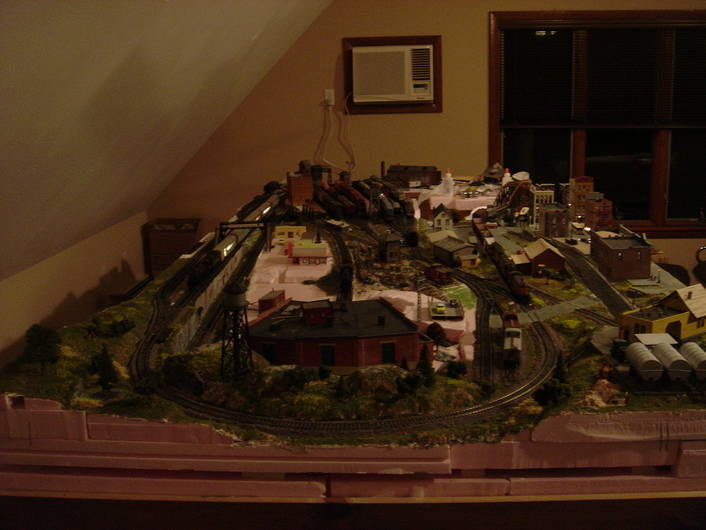

This is an overview of my layout from one end. In the foreground, there’s some high ground, and the roundhouse is nestled down behind it. This hill hides the train as it runs around behind the roundhouse. (The nominal “front” side of the layout is to the right.)

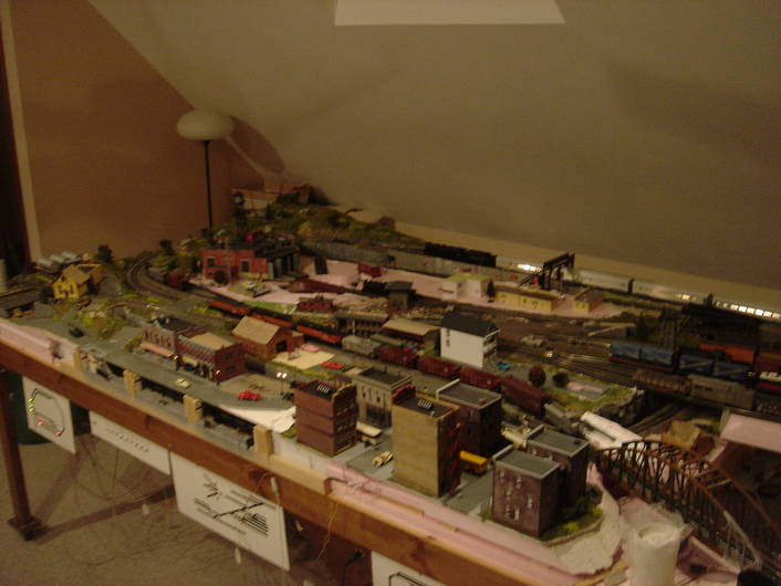

The next shot is from a different angle. (I think I was replacing the battery in the smoke detector this day. Anyway, I had a big ladder in the room, so that’s where I shot the picture from.) In the foreground here is the “downtown” area, with 3 and 4 story brick buildings.
Finally, here’s a shot from a more normal viewing angle. The tracks are barely visible behind the buildings, and the trains only show up when they cross the street.
