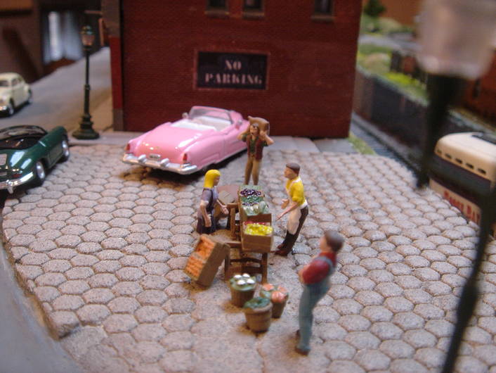

I remember hexagonal cobbles from my childhood. I found nothing of the kind when I looked, either in model train places or in gaming supply stores. So, I improvised. I contacted a friend who keeps bees, and found the name of a supplier of artificial plastic honeycomb. I ordered one section from him, and used that to cast a “positive” impression out of modelling clay. I used that to create a “negative” mold out of latex rubber, and finally cast hydrocal sheets using this mold.
I call this scene “Farmers’ Plaza” because of the farmers’ market figures from Woodland Scenincs.
This is a trolley stop on the other side of town. Here, I had to cut the casting very thin to fit it on the ties and not interfere with the trains above.

Mister Beasley, nice shot… nice stuff… I thank you. Hey I even noticed your cracked steps… looks real~ Who would have ever thought of simulated honeycone as a cookie cutter / mold away~ approach. But hey… thats the kind of pics I was looking for.
