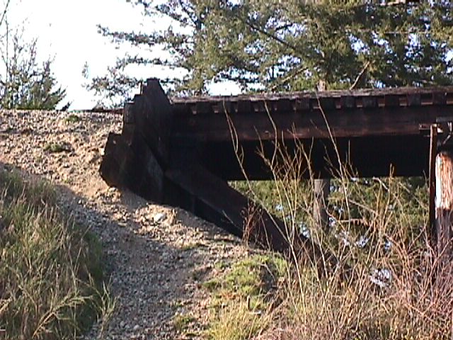

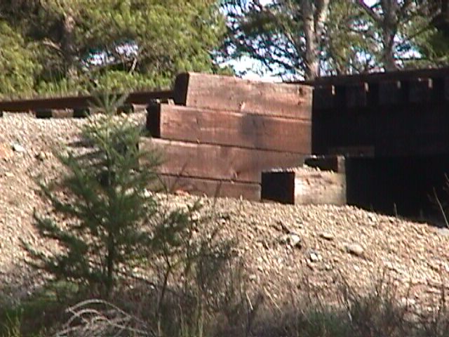

Well, I finally have the pictures, but I’m not certain if they will come out on this forum very well.
The first one is from the side and shows that extra reinforcment planks were added to this bulwark.
The second one shows another trestle bulwark and it appears that this bulwark has a full bent in front of it, buried in the ground:
I hope I get these photos displayed correctly. This is the first time I’ve tried to add a photo to one of my posts.
(3/7: Yup…checked the post from work and no photos. Wayne was right. I hope he gets them posted so David can see them…(Note to self…get old website back up and running…))
[:D] 3/7 PM-- SPECIAL THANKS to muddycreek, who has graciously hosted these photos on his rr web site. Thanks, Wayne!!

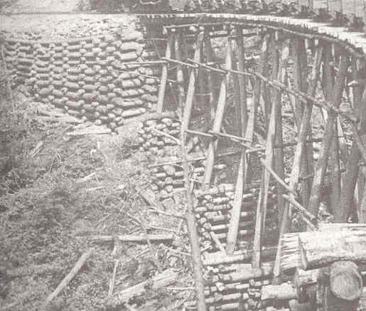

David: Here’s part of a photo showing an early 20th century trestle with some pretty impressive log bulworks. Built by a logging road with a short life expectancy, they were not designed to be long-lasting. Still, it might be helpful.
(This is a detail from a photo and I don’t believe its use violates copyright laws but I’m going to remove it shortly just in case.)
