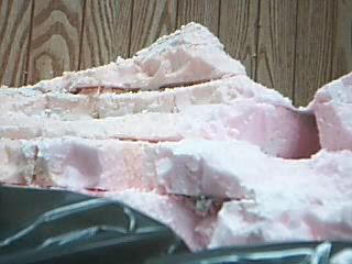

I use the white stuff as it’s easy to carve. The beads do show until I cover the mountains with many coats of Durham’s water putty and then it takes on a real nice stone texture. The water putty has gypsum in it so the mountain is about as fire-proof as a rock when done.
Full slide show with pictures is here:
http://home.mchsi.com/~ironmaster1963/wsb/html/view.cgi-photos.html-.html
