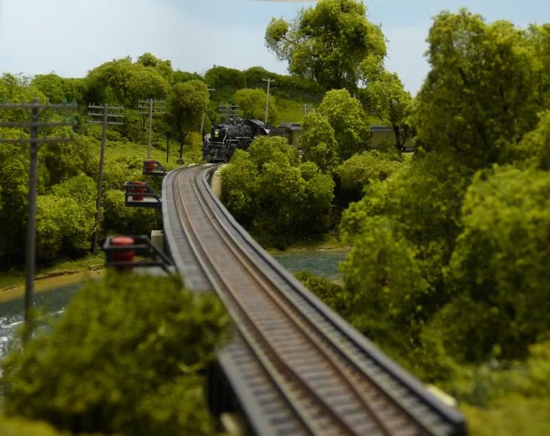

Hey Bob K.,
Not trying to hijack the thread but in one of your photos with the bridge in the scene, is that a forest fire in your backdrop pic? As a firefighter heading into fire season out west here, I couldn’t help but notice that. Cool scene!
Duane
Actually this is still somewhat of a debate at the club. The artist that did the backdrop won’t diclose the intent. I thought it was mist rising from the canyon/ valley. I actually needed to airbrush a “fog/ mist” to the painting to show a haze and knock down the sharp contrast. The painter does have a dry sense of humor, a sign entering a firetrail (under the bridge) says "Entering Viagra Canyon, home of the tall Woods) There used to be very tall pines that were modeled quite nicly but overpowered the scene. So you make the call as we do. It does look like a forest fire in the pic. One member a retired MA Park ranger built the fire tower so they “better get on that fire”
Early pic before final touch up
And this: Sunrise, fire or nuclear blast!
Now back to Art’s “forest” before it goes up in flames…
