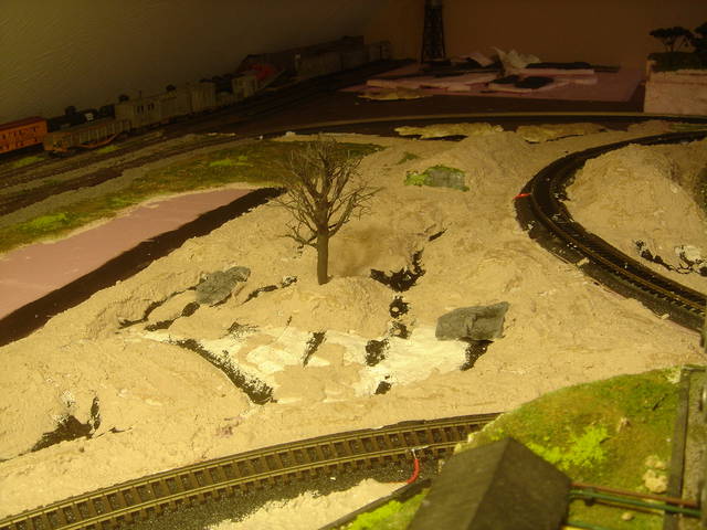

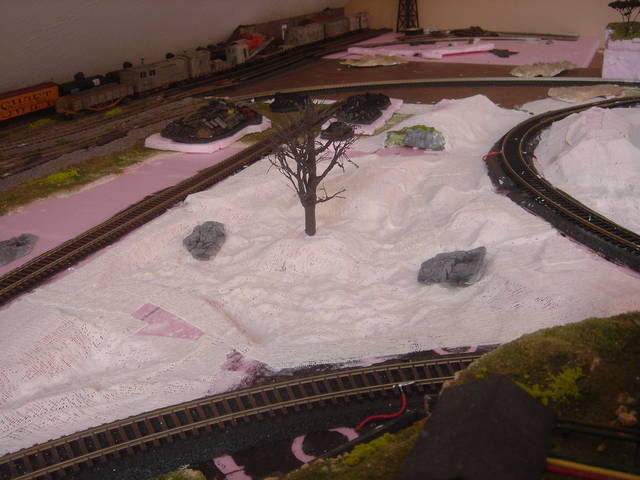

I generally use Gypsolite, a gritty, rough plaster, as my skim coat on top of plaster cloth. Here, I’ve dug out my swamp and coated it with plaster cloth. I used white glue over the swamp bed, because I wanted to seal it for the Envirotex to come later.
Gypsolite is naturally a light gray in color. I add a bit of brown acrylic craft paint to mine. In this shot, the Gypsolite has dried and I’ve painted the low spots black to add depth to the swamp.

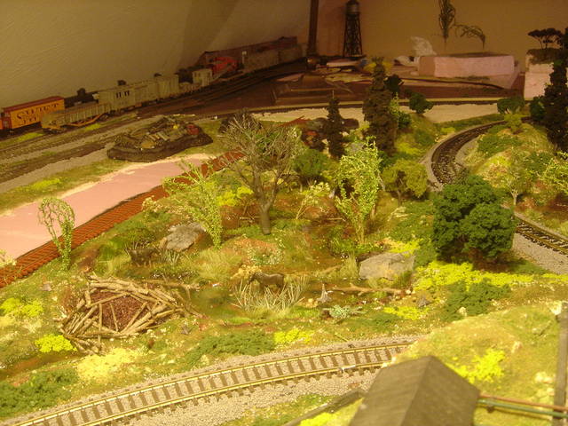

Paint, Envirotex, turf and ground foam, trees and some moose and beavers later…
