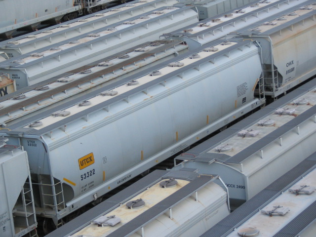

The two major differences are on the top and bottom. On the top, the hatches on a PP hopper are small round hatches and there are about ten of them lined up single file down the center.

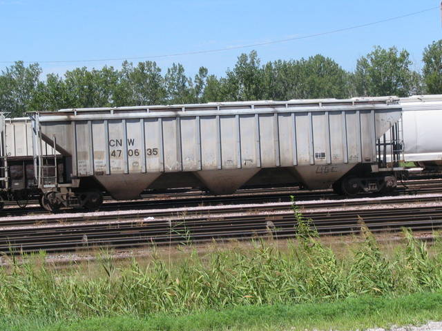

The grain hopper is on the left and the PP hopper is on the right.
On the bottom of the PP hopper are discharge chutes that are connected with hoses that keep from outside contaminants from entering the load.
You can see these here:
The PP are discharged from the car via a vacuum system which then places the PP in storage silos or in a specially made semi trailer.
The grain hoppers on the other hand have the large, long hatches that run down the middle of the car. The bottom discharge hatches are bigger and the grain flows freely into a floor grate or an auger. It doesn’t matter if the grain has contaminants or not as long as the grain is dry.
Here is a pic of the grain hopper’s discharge chutes:

Pellet cars normally have a round hatch in the roof as shown in the pictures. Grain cars typicaly have a trough hatch for loading.
Pellet cars have a pnuematic unloading gate, the product is “vacc’ed” out of the car. Grain cars have a sliding gate and gravity unload.
Pellet cars are owned by car lessors or chemical companies.
Grain cars are owned by railroads, grain companies or lessors.
Pellet cars are typically 4 bay, grain cars are normally 3 bay but can be more.

A grain covered hopper:

Your theory is right, your practice in this case I am almost sure is wrong. The three and four bay covereds all appear to be of the same length-55’ and some change. The bays are just spaced differently and may themselves be different sized. I do notice in the provdied pictures that the pellet cars have bowed sides, instead of the grain having flat sides, and the pellet cars appear to be a lick taller.
A 263000 lb max pellet car will be larger than a 263000 lb max grain car because pellets are lighter than grain and so you need more cu ft to make 263000 lb of pellets.
A 286000 lb max grain car will be about the same size as a 263000 lb max pellet car.
By making a car with 4 bays, you gain more cu ft of capacity because you loose less to slope sheets and the extra bay holds more. So for a car where cu ft is to be maximized (light commodity) , 4 bays make sense. On a grain car there is no advantage to extra bays because the cubic capy of 3 bays will max out the weight capy.
