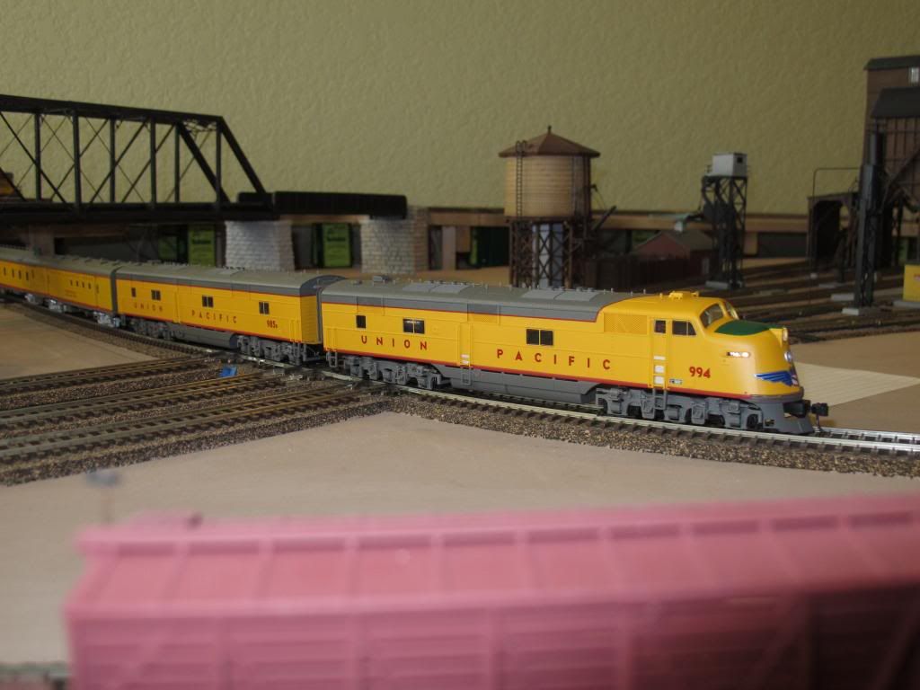

Glad to report that yesterday I found a new in box Lifelike Proto 2000 E-6 UP A-B set at the local train show, with DCC/sound. It took me awhile to get the address set as the NCE program on the main one setting long address change did not work right, but following the CV changes to change the address per the manual worked fine. I was concerned, after purchase, about the cracked gear issue on the P2K’s, but on another thread someone noted that the gray boxed items are later versions that do not have the flawed sized gear holes that caused cracking.
The loco behaves a bit funny on acceleration (waits & revs, then moves) and slowing (slows too fast), so I need to see if more CV adjustments are available to adjust those momentum type behaviors.
It looks nice with the RPO plus 6 passenger cars.
We need to see some pics?
Not great photography nor any scenery, but here goes:
Nice looking train,Paul.[tup]
Mike
