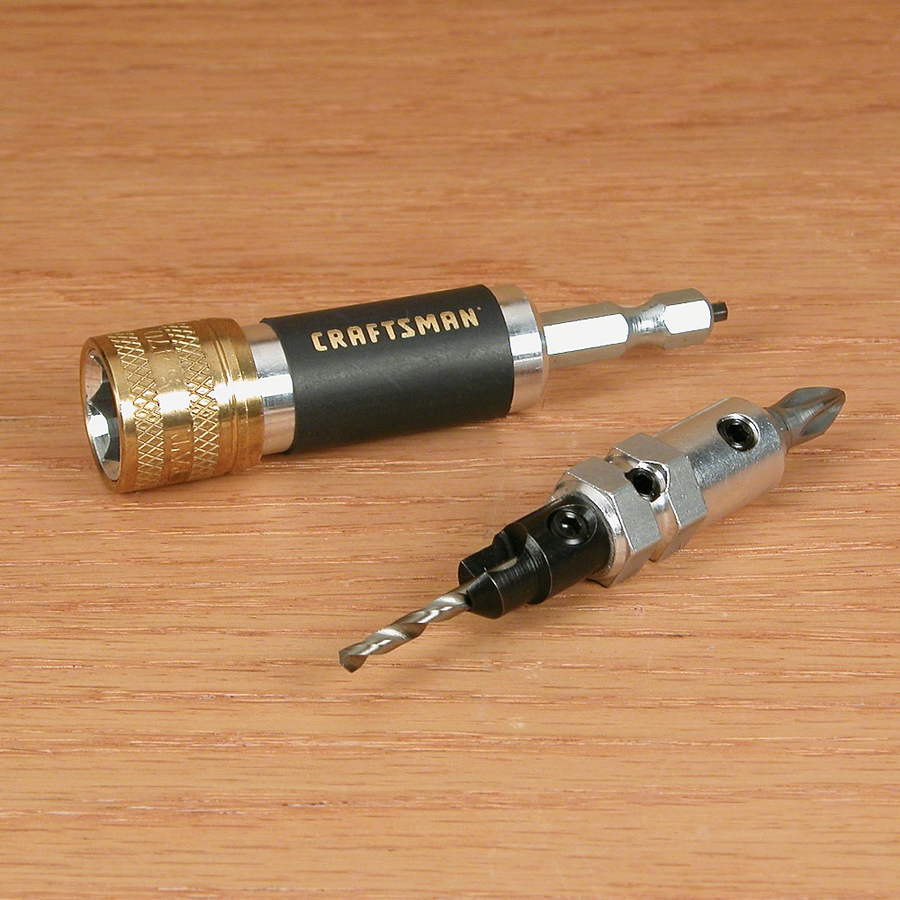

If you have a lot of screws you need to countersink, you might want to get something like this:
This one comes from Sears, naturally(or K-Mart), but there are several companies that make versions and you should be able to find them at Lowe’s or Home Depot or other hardware stores, maybe even Wal-Mart or Target. This has a quick release that lets you flip the bit around to switch quickly between drilling and driving.
