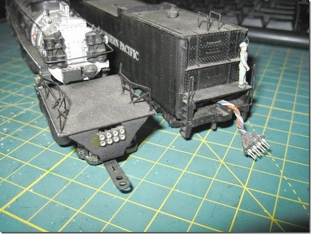

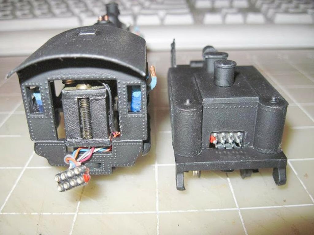

I wouldn’t worry about the Power Pack problem! I started out using DC in 1951 up to today. In 2006 I decided to go with DCC and bought a MRC Prodigy Advance ². I used a 12 volt DPDT relay to switch my layout track from DC Power Pack to DCC Controller automatically. When I turn on my MRC Sound & Power 7000 DC Power Pack the Accessory output pulls in the relay switches my layout from the DCC Controller to the DC Power Pack.
I can run in either DC or DCC mode without any problems with this configuration. The two systems are never connected at the same time. I have over 70 locomotives and only 13 decoders, all locomotives are wired for DCC Ready. I have a couple of tenders with sound decoders and speakers that I can easily swap to any of my steam locomotives by simply plugging them into the locomotive.
I have a pair of E7s with sound decoders that are semi removable, meaning I could easily remove the decoders but because I run them quite often I leave them as is. The rest of my diesel fleet are easily made DCC operational by plugging in a decoder.
I can run any of my locomotives on my layout
