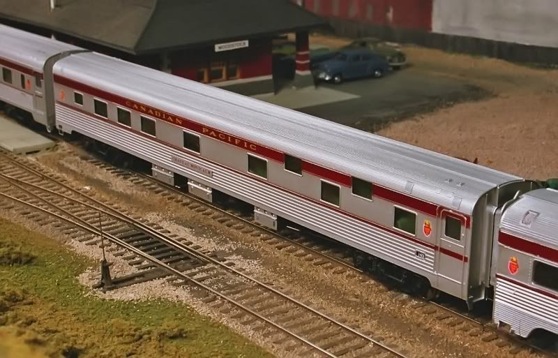

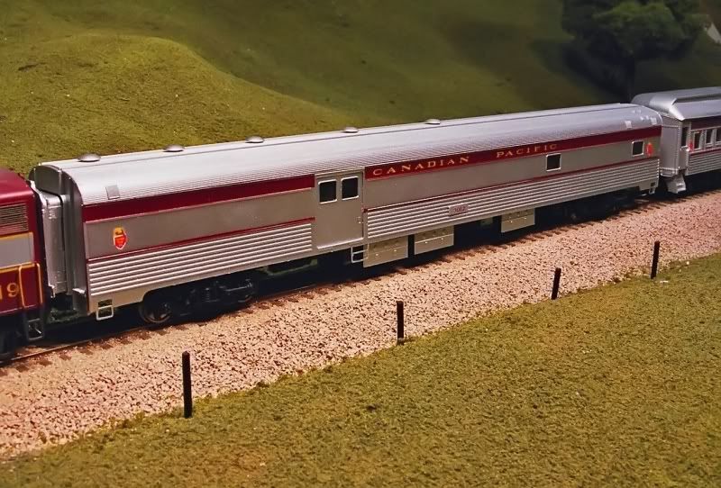

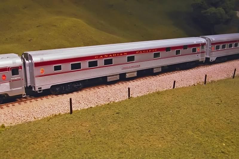

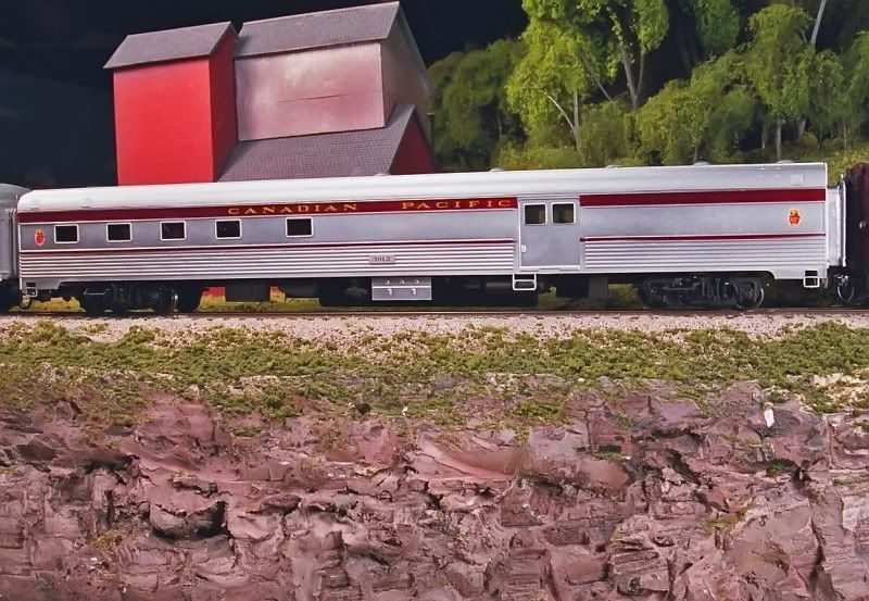

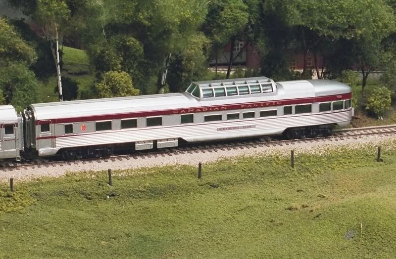

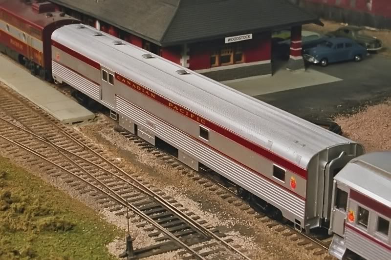

Most of my CPR “Canadian” is standard Walthers Budd coaches and sleepers as they looked close enough for me. For my “Park” Dome-Observation car, I used the Con-Cor car with a few minor mods.
The baggage-dorm and Chateau sleepers are quite distinctive, so I also used Athabasca sides with Walthers Budd cars as “cores”. The sides fit very well. I found that they are thinner than the plastic sides so I shimmed them with clear styene which also creates the glazing for the windows.
Here are some photos of a CPR Baggage Dorm and Chateau sleeper done this way.
