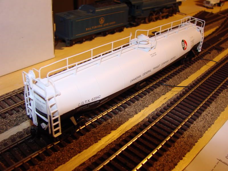

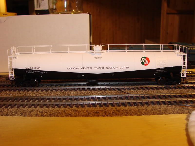

I believe you are correct. When I bought mine there was only 3 numbers available. They also did a 6 car run of BA (anybody remember them?) tank cars as well. I have all six of those but these one’s are white.
Got a pic please?

Sure, here you go.
