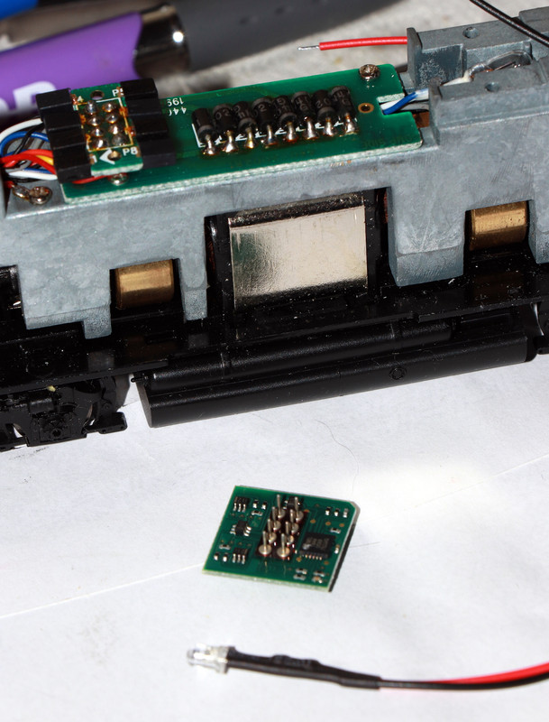

I scrap the lighting board.
DCC_PCBa by Edmund, on Flickr

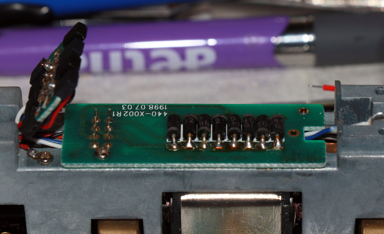

The GP-20 board did have an odd setup where a bronze contact strip that engaged the top brush holder was part of the PC board :
DCC_PCB-gp20a by Edmund, on Flickr

That’s a mess of circuit boards Ed. Yes, I was afraid if I just kept prying straight up, the bottom cover would crack.

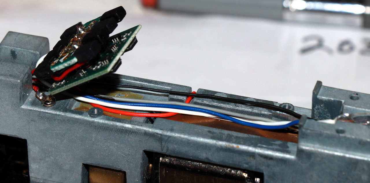

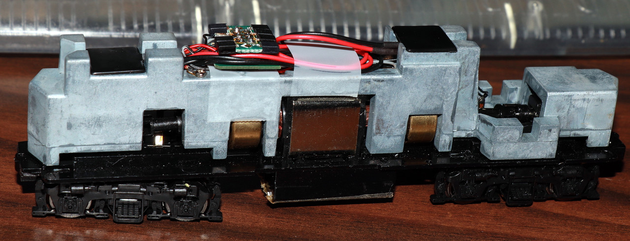

Big Daddy wrote: “I have only hard wired pre plug locos. I was expecting the decoder to plug into the circuit board, but the CB has male pins.”
At least some of the Proto2000 (Lifelike) engines have a (for lack of a better term) “reverse 8-pin wiring harness” with female connectors, to which all the wires attach. This plugs down “over” the male pins on the light board, which is mounted to the weight with screws.
This is a Proto2000 GP30, but the connection scheme is the same:
You can see the small decoder that will replace the light board (at the bottom of the pic)
The wiring harness lifts off, and you can see the male pins on the light board:
Remove the light board and the decoder plugs into the harness:
And here it is with headlights before the shell goes back on:
