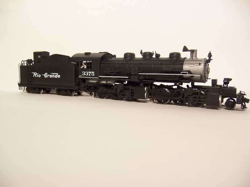

Need a recomendation for paint for my PRR M1a mountain for the smokebox. I prefer a water based paint for airbrushing, rather airbrush it than paint it on with a regular brush. I painted the rest of the boiler with Badger Brunswick Green and my harbor freight special deluxe airbrush, turned out nice! Mike
