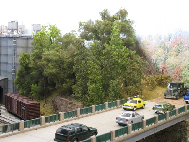

Well here is an example of puff balls with super trees and others in the front
This was one of the first parts of my layout and whilst the puff balls really don’t stand up to close scrutiny they serve the purpose of suggesting a hillside of trees. I do think it is important to hide the margins with better looking trees, and of course foreground trees need to be much more detailed. I think what they do is to provide some sense of forced perspective. The hill feels like it goes much father into the distance than it would if they were all Super Trees.

!(http://i297.photobucket.com/albums/mm237/GrampysTrains/Super Trees/P1040153.jpg)
!(http://i297.photobucket.com/albums/mm237/GrampysTrains/Super Trees/P1040235.jpg)
!(http://i297.photobucket.com/albums/mm237/GrampysTrains/Super Trees/P1040220.jpg)
I’ve made approx. 1900 puff ball trees, using Dave Frary’s method. Some have detailed trees in front, some don’t, depends on the scene. JMHO. DJ.
!(http://i297.photobucket.com/albums/mm237/GrampysTrains/Super Trees/P1040218.jpg)
Excellent illustration Grampy, some really nice photos. Your hillsides look really good.
Thanks, Simon. DJ.
