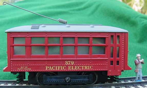

Is this perhaps what it looks like?
If so, are you sure that all four wheels are turning when it “can not get any traction”?
The only differences are that mine says “377” and the screw between the wheels is no where near as big.

I was making very good time with the setup for my grandson so I decided to bite the bullet and, even with my aging eyes, convert to DC operation (the rectifier was included). I got a small HO power supply and surprise, surprise, that was what was needed. The trolley now works!
