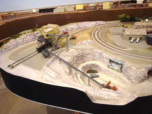

Here’s a peek at how I built my quarry with styrofoam. I used 2" because I had it on hand. 1" thick should work even better. The whole thing is removable.
The derricks are from the Walthers quarry mill kit and not currently in stock. Here’s a peek way down in the quarry hole…
Pictured is a quarry on G Paine’s layout.
