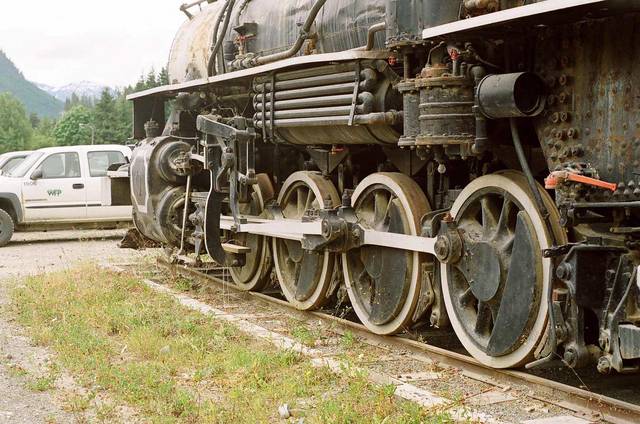

The “blind” drivers are without flanges to allow the basically rigid wheel base of steam locomotive drivers to be able to negotiate tight curves. A 2-10-0, for example might have the #3 drivers blind, so their flanges would not bind in a curve.
I am not sure of all the criteria for blind drivers, but I think they were a rather unique design feature that was applied to narrow gage locomotives that had to deal with relatively sharp curves, and smaller standard gage locomotives that might be used on logging or industrial railroads. The blind drivers would have to be confined to the inner drivers of a set, of course.
Right you are. There is a now-retired Mikado in Woss, British Columbia (on the Island) whose center two drivers are blind…leaving only the outer two flanged to guide the locomotive.
