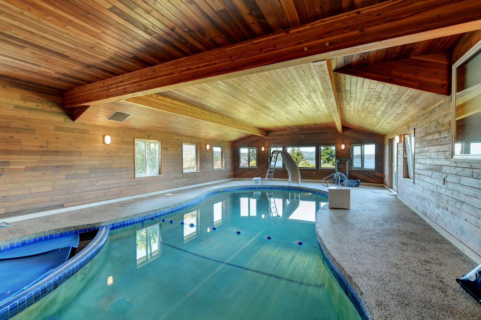

This is the third house the wife and I really like that has had an indoor pool. Neither one of us wants a pool, however, we really like this house a lot. My question is, could this pool room have the pool drained and a floor built over the pool and covering the entire room making it my trainroom/mancave. Seems easy enough but what is it I am not thinking about? We want to leave it so when we sell, a perspective buyer can retun it to being a pool room again by simply removing the floor.
Would the structure of the pool be compromised by leaving it empty for years?
The house isn’t huge, this pool room takes up a large percentage of the total floorspace.

I am certain that the pool will not be damaged by leaving it empty any number of years. You will want to be able to protect it before you cover it. Be sure that you “winterize” the pool equipment.

It should be fine. Because the pool is indoors, it is even more stable than a pool outdoors. The building foundation protects it from surface ground water, freezing, etc.
Important detail - all concrete in gound pools have plugs in the bottom to relieve ground water pressure. Leaving the pool empty will require removal of these plugs and it would be a good idea to install a sump pump at the deepest point in case ground water enters thru the removed plugs.
Most concrete pools are like boats, without the water in them they displace more than they weigh - they will float out of the ground unless the plugs are removed.
Spanning that distance will require a floor deck of some complexity, but is very doable.

Sheldon’s advice is right on! Ground water can either push an empty pool upwards, or if the drains are open, water can and will seep in - requiring sumps.

The real winter fear is that the pool will float out of the ground - especially with some of the water tables here by the bay.
Properly winterized, an indoor pool would have no measurable amount of water in the pipes. But yes, pump seals and such would suffer from extended dry storage.
In fact, most pools are winterized by blowing out most of pipes and capping them, then adding antifreeze where rain and snow will fill up.
Decades ago, in the 1960’s, Sylvan Pools had commercial pools they had built washed right out of the ground without cracking the shell during several hurricanes in Ocean City and other Atlantic beach resorts. They were actually able to reset the shells and restore the pools.
But draining a pool without removing the plugs, espeically for an extended period of time, is asking for trouble.

One of the pools had real problems. One being that even if the ground water level isn’t very high an empty pool can float when left empty. The area didn’t have an exceptionally high water table but never the less after a good rain one of the empty pools popped out of the ground. There wasn’t a fix! It had to be replaced.
The pool that popped out of the ground was Olympic size, 140,000 gallon capacity made out of concrete. I wouldn’t mess around with Mother Nature.

I would go to the longer perimeter walls and snap lines perpendicular across the room 16" on center, right over the pool. I would measure the longest distance between those snaped lines across the pool and check maximum span ratio on I-joists.
Then I would build sections of support walls (In) either side of the pool… minus the width of the I-joists and tie them together with two-by-fours so they can’t go anywhere.
Then I would run one by threes across the snaped lines and the I-joists to span the room for your plywood.
Tapcons through the one by threes on the concrete deck (very sparingly, where is it going to go anywhere after the plywood’s attached?) and screws into the I-joists but absolutely no fasteners in the pool in case anything is ever changed. It looks like your door has plenty of clearance for adding an inch and a half to the floor.
