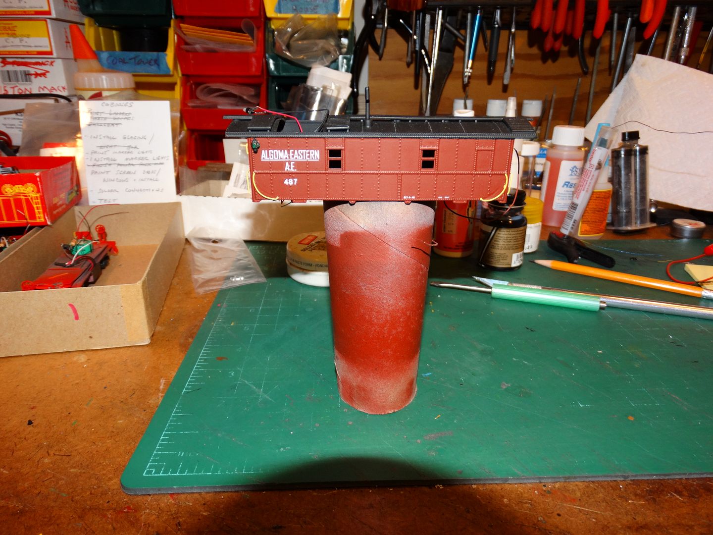

An empty toilet paper role fits quite snuggly into freight car and caboose bodies and gives you a nice sized handle. Best of all, its free. I recently used them to paint a fleet of cabooses and they worked very well. One nice feature is that the tubes will stand on their ends so you can put the model down (being careful to not knock it over of course) and move on to the next car. I used four rolls to do eight cabooses but I could have had eight for the same price[swg].
