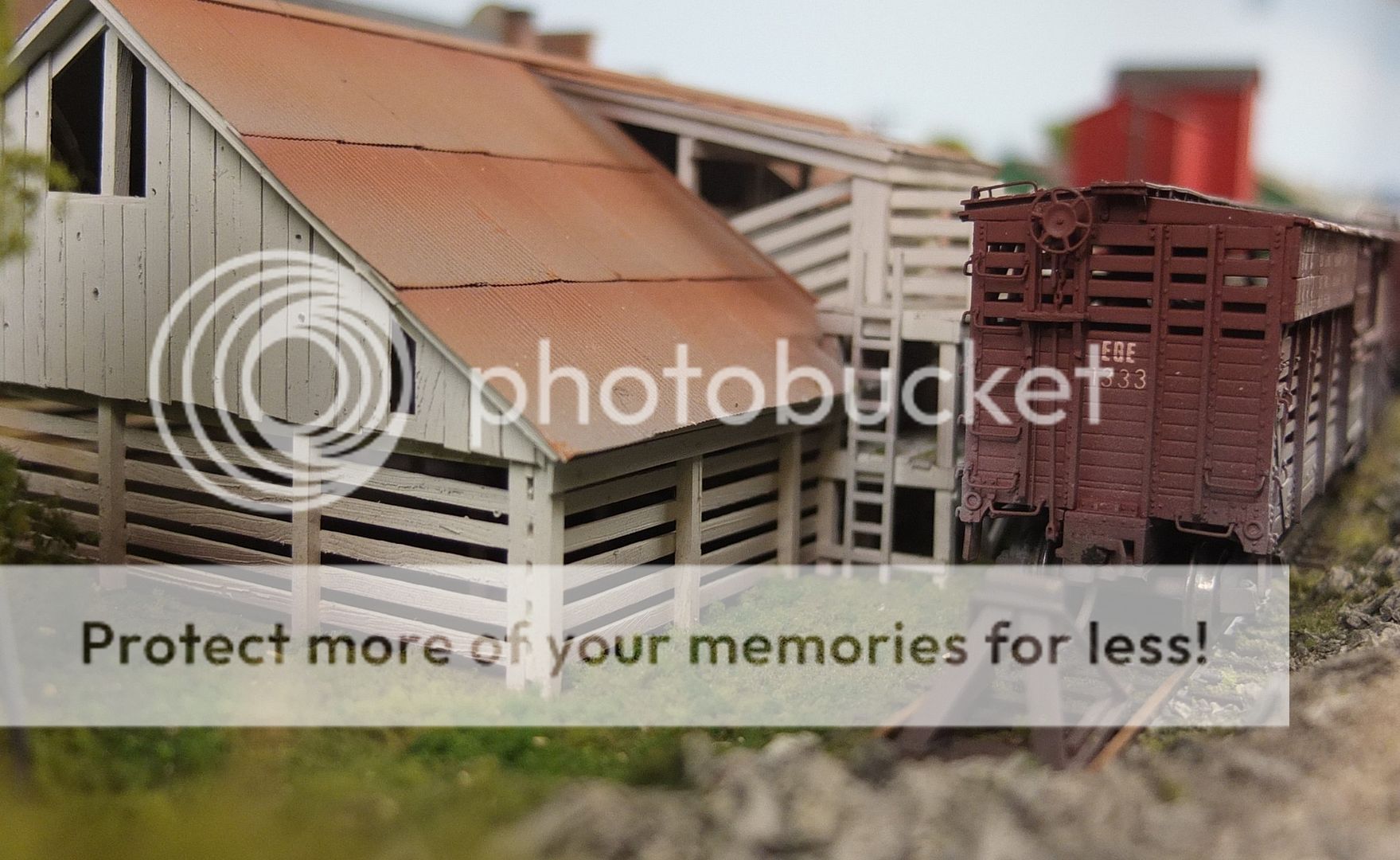

I’ve seen photos of positionable ramps, but none showed the mechanism clearly enough to build a model. I built the version below, with fixed ramps, from several photos of different ramps, so it may not be strictly prototypical. The design is logical, though, and it looks good enough for my purposes.
I added the roof specifically for hogs, although the pens will hold any type of livestock. I seem to recall reading that some stockcars carrying hogs used wet sand instead of straw, in conjunction with the watering stations. Must’ve been a lot heavier work to clean them out.[swg]
