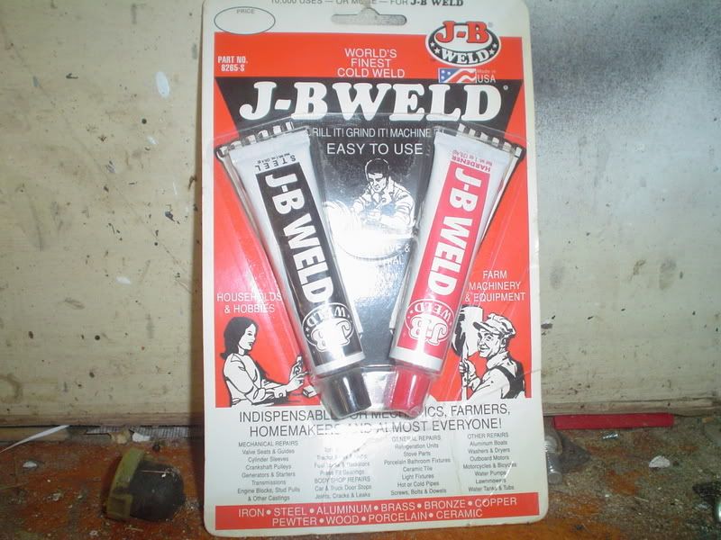

I was in your shoes a couple of months ago, I had cut a section of track about 1/8 inch to short. It did not cause any problem except that it went click click as the train rolled over the joint. I did a quick and easy fix with JB Weld and worked great. JB Weld will not conduct electricity, and it is easier to do than soldering and it is easier to file. Hope this was helpful. Mike

I’m finding this interesting, seeing as I have lots of gaps. Please forgive the dumb question, but what is JB Weld?

It comes in a plastic bottle, and looks and feels much like white glue. It claims to be much stronger than carpenter’s glue.
I do not mean to critize your comment but JB Weld is a 2 part epoxy, one is called the metal and the other part is called the hardener. when mixed together it forms a grayish black paste that can be put in a rail crack with a small spatula ( or the tip of a knife) allow this to set for a few hours then carefully trim the excess, leaving a littlle above the rail head. When completly dty ic can be sanded or filed like real metal.
The reason I went with this method is that the gap on my rail was at an insulated joiner so solder was out of the question. You can get JB Weld at most auto parts stores or Wally World.
Here is a pic of the package you will be looking for:
And here is a pic of the repair:
Hope this will help Mike
Oops. You are perfectly correct…I must have had a senior moment. I was actually thinking of Weld Bond.
I am sorry for my misinformation.[:I]
