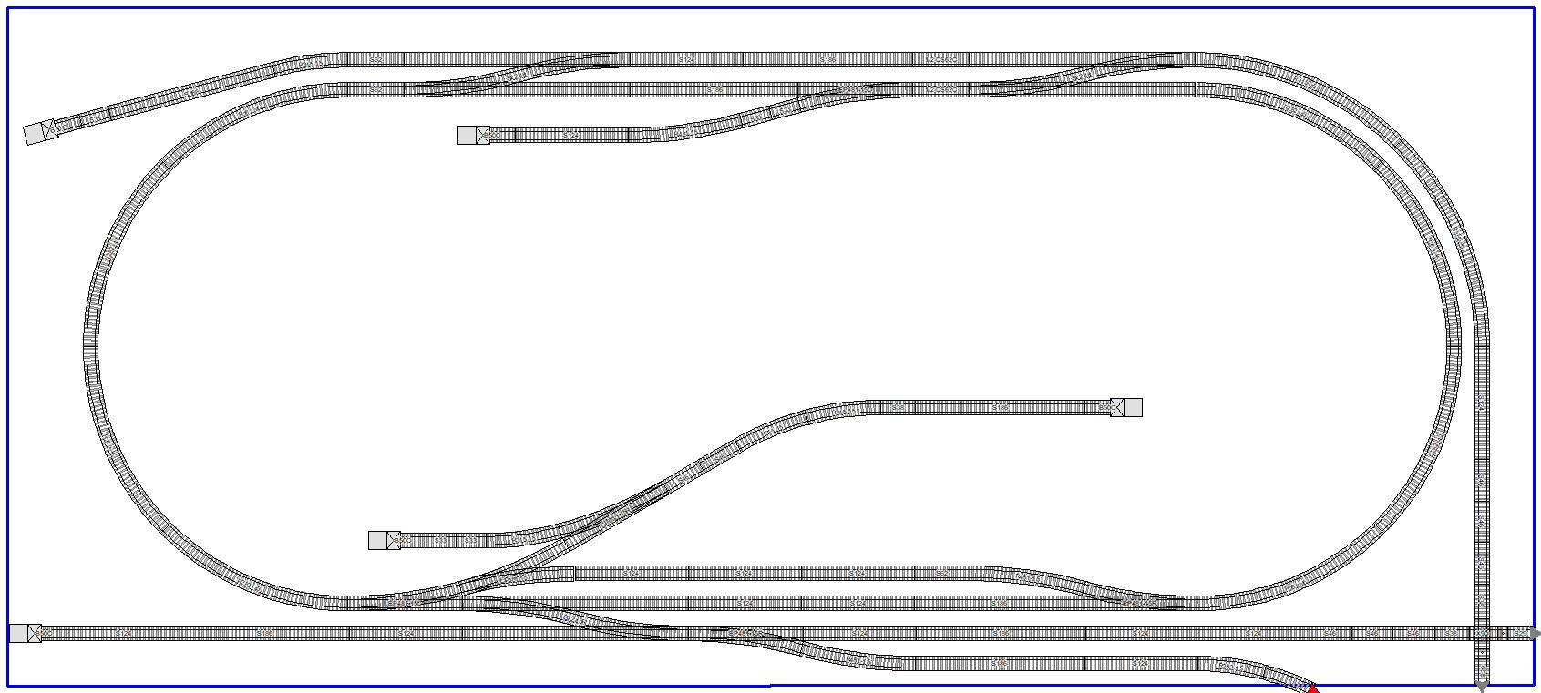

Thanks everyone for your suggestions, I have made two alterations to my plan, im hoping you all can help me refine them a bit more or give me some more suggestions. alteration 1
This is my first alteration, I elminated 1 of the S curves, lengthened the back passing siding, and removed one of the gravel sidings, to reduce the amount of cars needing to be swapped at the gravel plant. The lumber yard would be relocated to the bottom left corner.alteration 2

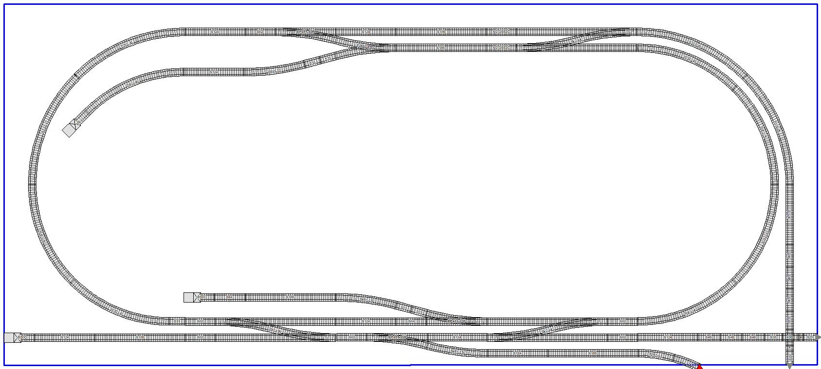

This is my second alteration, it eleminates all s curves from the circle route, the gravel pit has been relocated to the outside of the loop in the top right, replacing the building with just a siding and a front end loader. An extra siding has been added to the back town that can be a team track.
The lumber yard is relocated to the bottom left as in the first alteration.however eve
Sorry, I just noticed the glareing double s curve to acess the interchange track in the second edit, here it is fixededit v2
There is no real reason that I can see to eliminate one of the gravel spurs. That short spur on the south side could also be lengthened and made a little more utilitarian. And I would also lengthen the interchange at the bottom as much as possible befor curving it off the layout to provide more track for rolling stock.

One other thing you can do with the siding on the south is to move the turnouts up into the curve so that the diverging end is straight across. Then you can curve into the mainline from the straight end of the turnout.
I would also flip the two turnouts on the right side of the north siding so that you can run a train straight into it from the mainline when it is traveling counter clockwise.

Since you’re using Kato Unitrack for this ‘temporary’ T-track layout, why not take full advantage of the temporary features offered by the Unitrack system? Namely, lay out the track plan and run trains for a while to see what’s what. Problems and nuisances and inconveniences will show up soon enough. All of the plans you’ve posted look doable, and since most of the pieces show up in most of the sketches, you won’t need to purchase a lot of pieces that would go unused if you change the layout. I have several shoe boxes full of the stuff that I occasionally noodle around with even though I’ve built what Granny might call a permanent layout.
Plus, with Unitrack many of the ironclad rules regarding layout design espoused on this forum do not always apply; such as tight radiuses or short reverse curve esses. I’ve run trains full-throttle through crossovers made with two #4 turnouts installed toe-to-toe with no ill effects. Well, not with no ill effects; but not with many. Unitrack is pretty forgiving about that kind of stuff. Pretty forgiving, not entirely forgiving.
