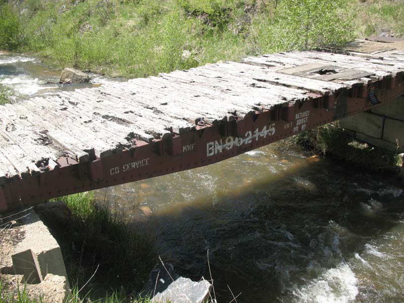

Road Bridges
The UP has converted lots of flats to ROW bridges along their route here.
