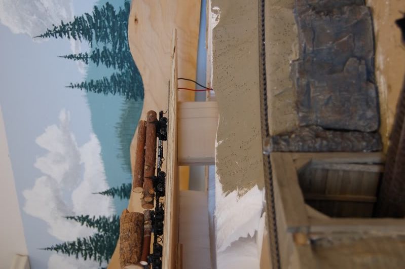

I depends on the time of year that you are modeling. We are doing spring time in the Pacific Northwest. I painted blue and my husband is the artist. He painted the clouds.
He started with white using a 1 inch brush and gradually stippled darker gray. He used the clouds outside the window for a reference.
Sue
