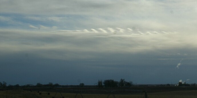

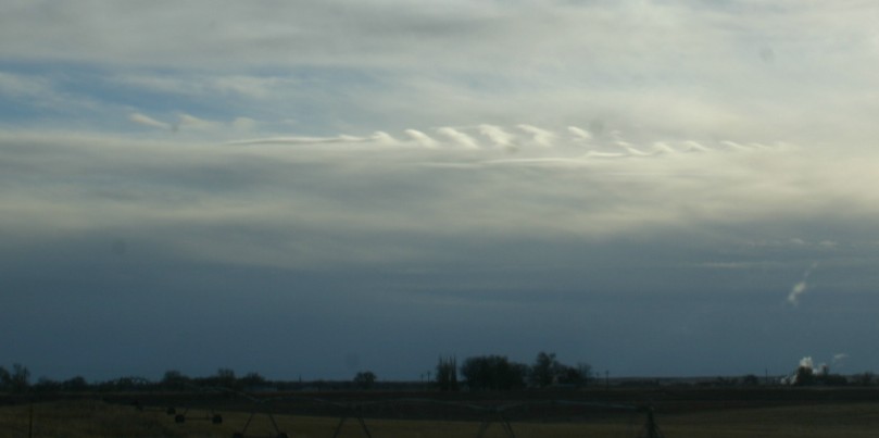

Here are some clouds I photographed this weekend. They looked like two rows of cresting ocean waves. This photo taken out the dirty windshield of a moving automobile, doesn’t do them justice. If anyone had painted clouds like this I would have thought they didn’t look real.

Those are called billow clouds. They’re formed by Kelvin-Helmholz instability (that’s the instability created by shear across two layers with different stability gradients). It’d be hard to get into why they look the way they do without delving into fluid dynamics, but although they look like ocean waves they’re formed by a different process.
Great shot, by the way. I’m an Air Force meteorologist working in the field of wave mechanics, and have only seen K-H billow clouds maybe half a dozen times in my life.
