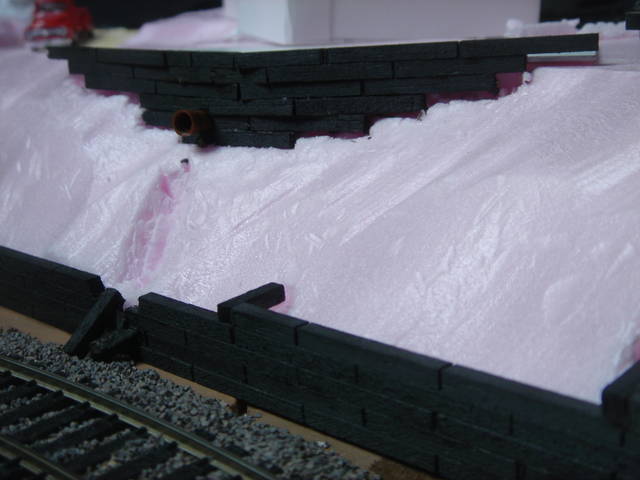

I used 1/8 inch square balsa wood to make this retaining wall.
I’ve got a small can of white wood stain. For a weathered fence, I add a little bit of India Ink. For creosote, I add more India Ink. I like to do the staining before assembly, because any exposed glue will not take stain afterwards.
The “timbers” are not separate pieces, by the way. I notched the long strips on the exposed sides to give that appearance.
