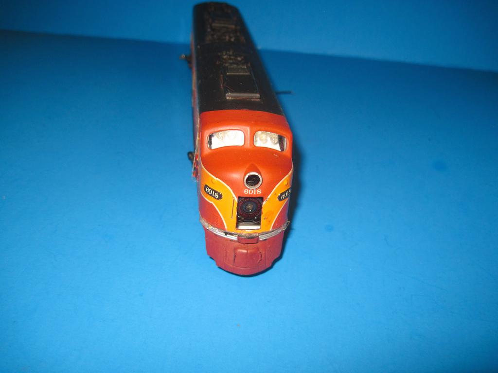

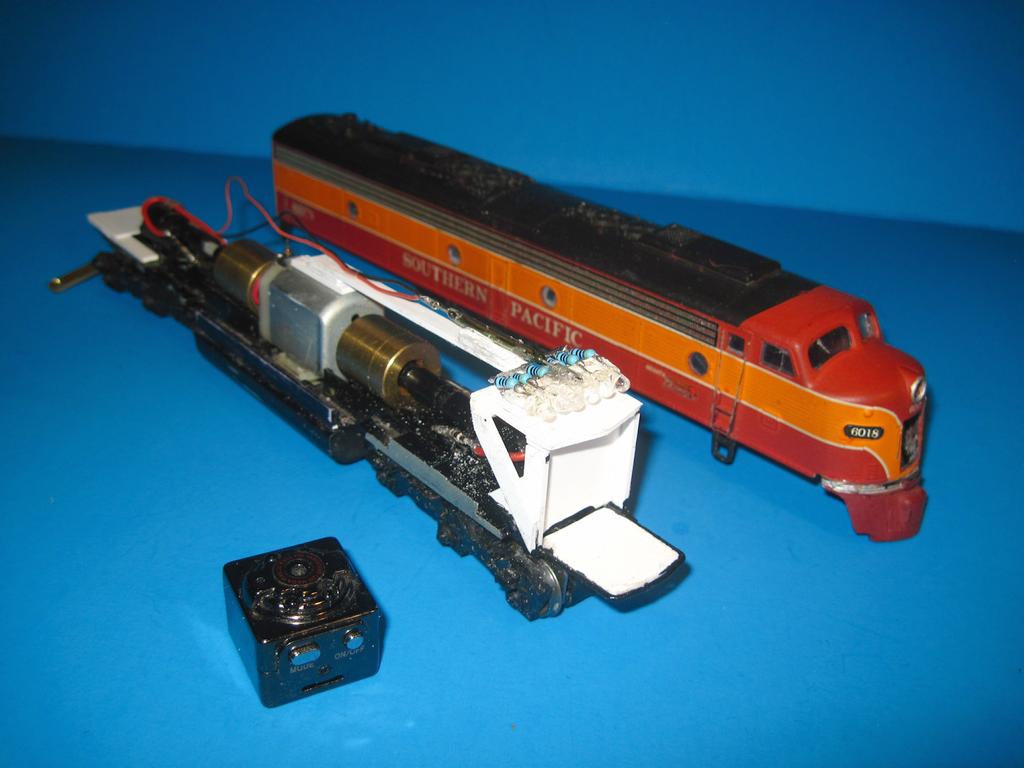

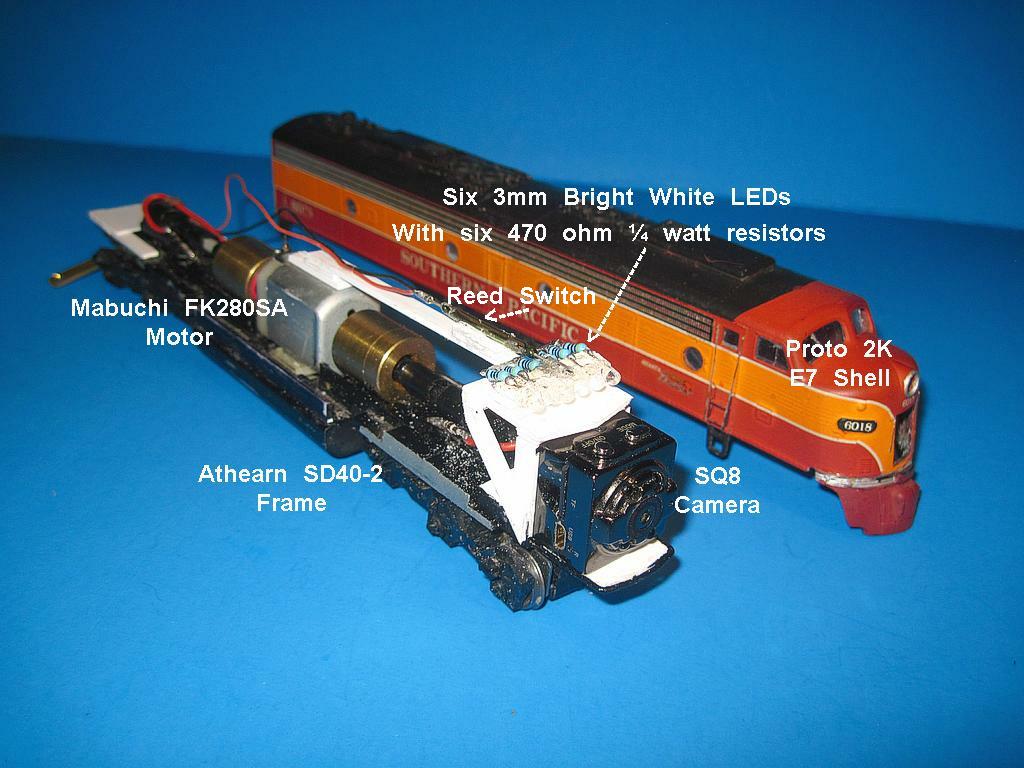

The SQ23 has WiFi as well as record but it’s a bit big for mounting in a locomotive. I have mounted a SQ8 on an Athearn SD40 frame and use a Proto E8 shell. The camera looks out the open front door.

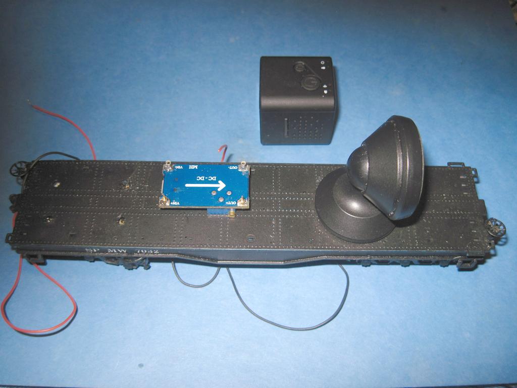

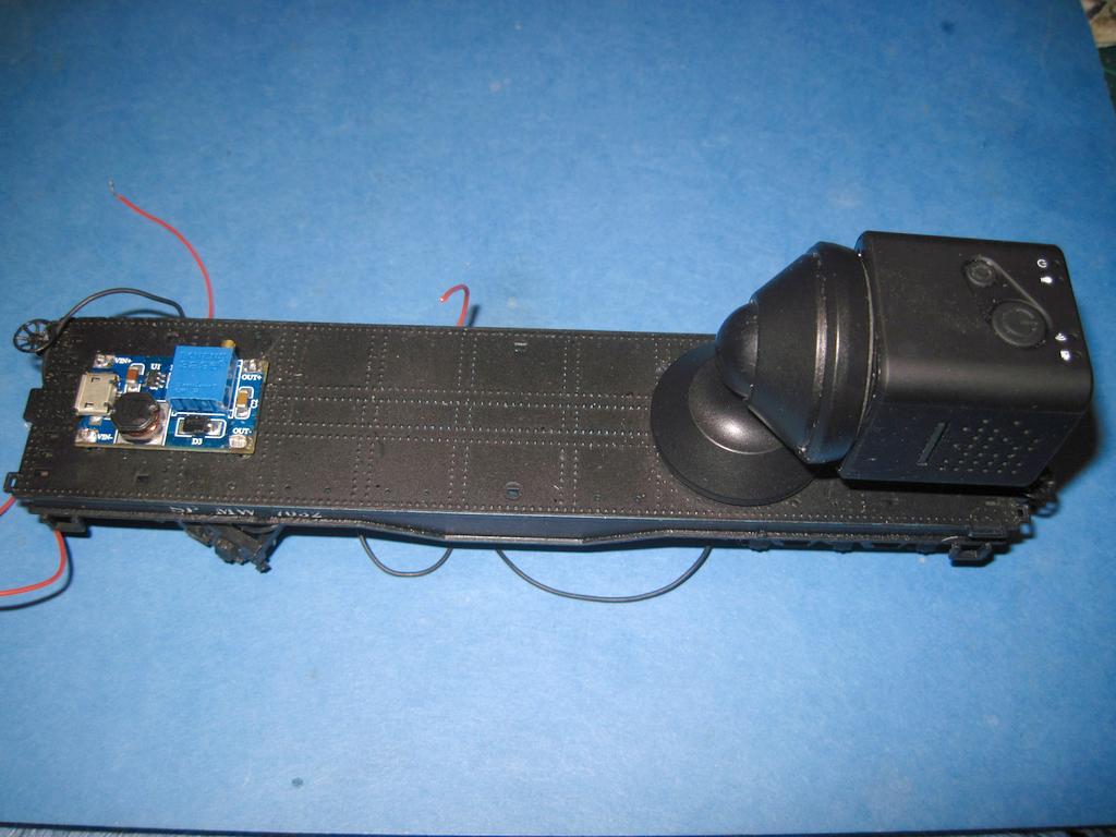

If you want to mount the SQ23 on flat car and push it that works very good.
I power the camera and LEDs from the rails using a micro Dc to DC buck converter.

This one pans 120° controlled by Andrino Bluetooth.

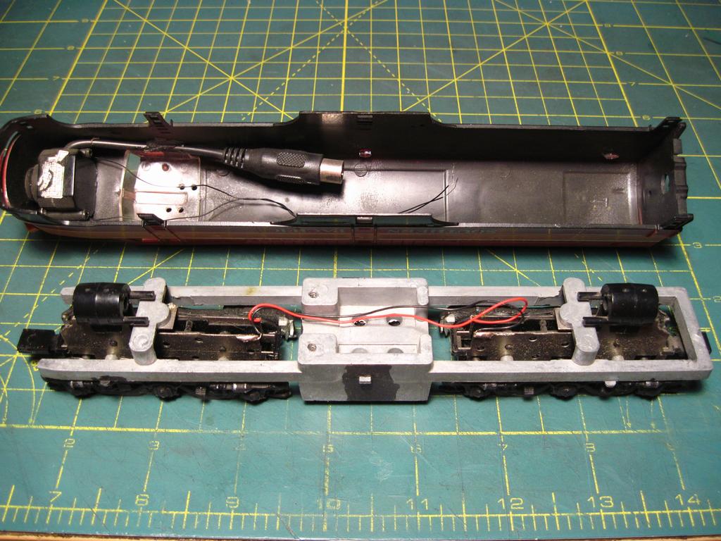

This is my first attempt back before I went with DCC in 2007.
This is an Athearn PA-1 dummy, I removed the motor and drive lines. The wireless camera is glued in place and powered from a 9 volt battery. The PA-1 is pushed by a PB-1. No fancy stuff, everything right out of the box.
The LED headlight is powered from the rails.
The camera has a self-contained 2.4gh transmitter that transmits to a 24gh receiver with video and audio output connectors. It has preformed very well over the years.

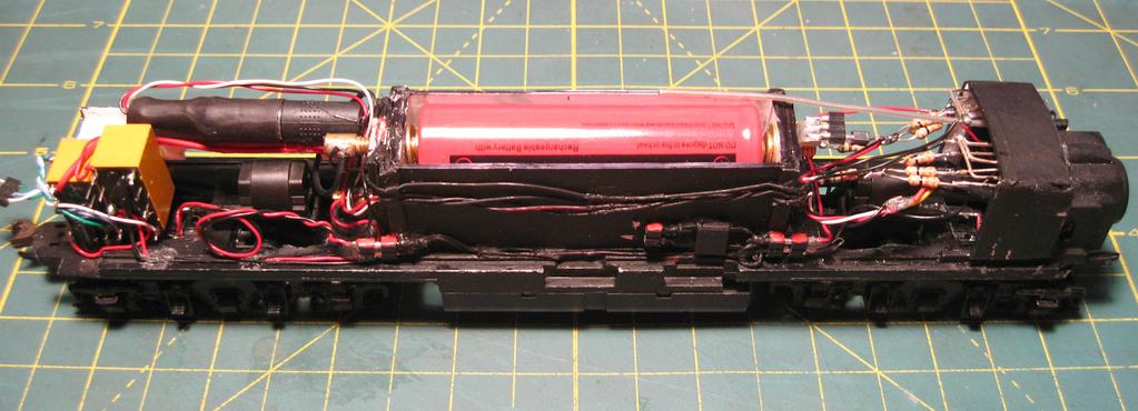

I bought a second 2.4gh wireless camera and installed it in a Proto E8A dummy. This time I used a pair of 18650 Lithium batteries for power and using a DCC decoder F function from the pusher I can turn the added LED lighting and camera on and off individually. I push it with an Athearn E7B. When operating on DC I installed magnetic latching reed switch under the top of the shell to trip the control relays.
