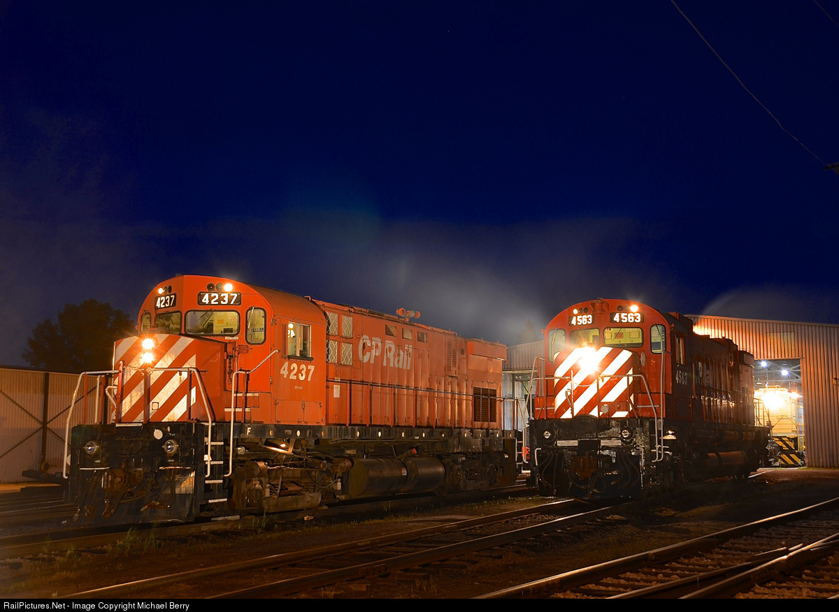

I was referring to the physical arrangement of the lights, which on many Canadian locomotives were physically separate adjacent red, green, and white lights in a row, as described in this article or as seen in this picture (the first one I could find browsing the Web)
Lights had the same meanings in both US and Canada - no matter how they were configured on the locomotive.
This was the system used on Alco Century Series locomotives. EMD locomotives used changeable colored lenses behind the exterior class light lens. Nothing Canadian about it.
I was just looking at CP pictures from the 1970s because of this thread. Early on the low hood EMDs seemed to have had a single changealble lens class light. Most where above the number board, but I did see a picture of a GP35 with them on the nose. Later on, they seemed to have went to the three light arrangement above the number board.
I wonder if placing the class light above the number board is the reason they went to a three light combo. It’s easier to flip a switch in the cab than to stand and reach over to change
Both Alco and MLW used that system. GMD-produced locomotives had the same movable class light system (at least initially) except it was moved up above the number boards.

Later GMD-built units seem to have transitioned to the three-individual-light system.
http://www.railpictures.net/photo/93574/
