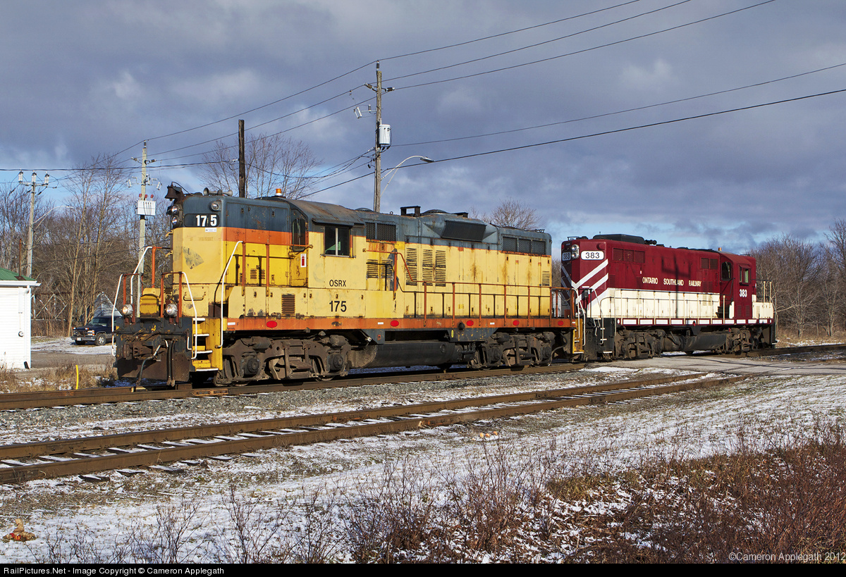

IF you have an air eraser, use baking soda and about 60psi and you can get the lettering off quite easily. That’s how I removed (almost) all the Chessie lettering and also “faded” the orange stripe on this Athearn Genesis unit …

WOW! You did a good job with that air eraser? Hope it was a big one. [:-^]

Here’s a link to the model without the “pretty backdrop” ! [swg] …

I thought the backdrop, was the model and the,Yeah! Right!. [(-D]
It’s nice how it blends in. I did see it before. [Y]

I’ve fooled a lot of people with that picture thinking it was real ! I must have taken about 50 pictures of the model to get the angle and lighting correct to lay over the real picture ! This is the real picture I layed my model over …
