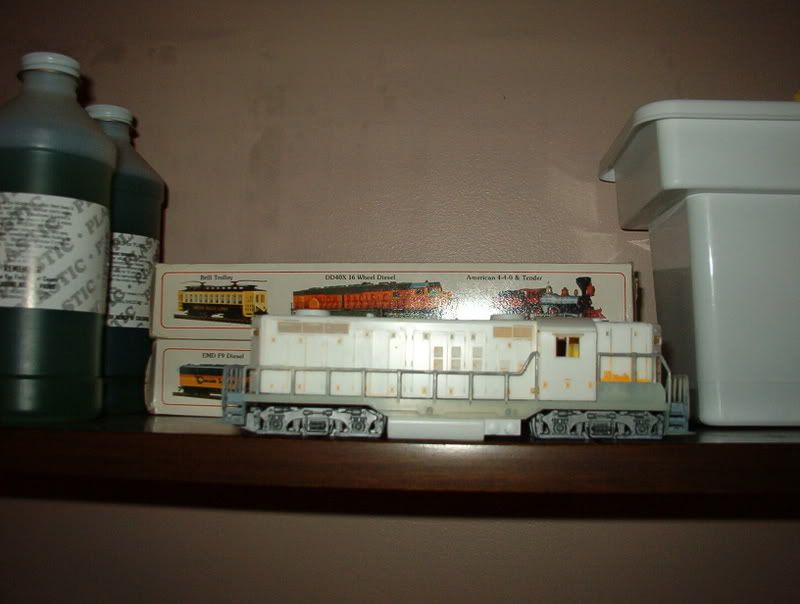

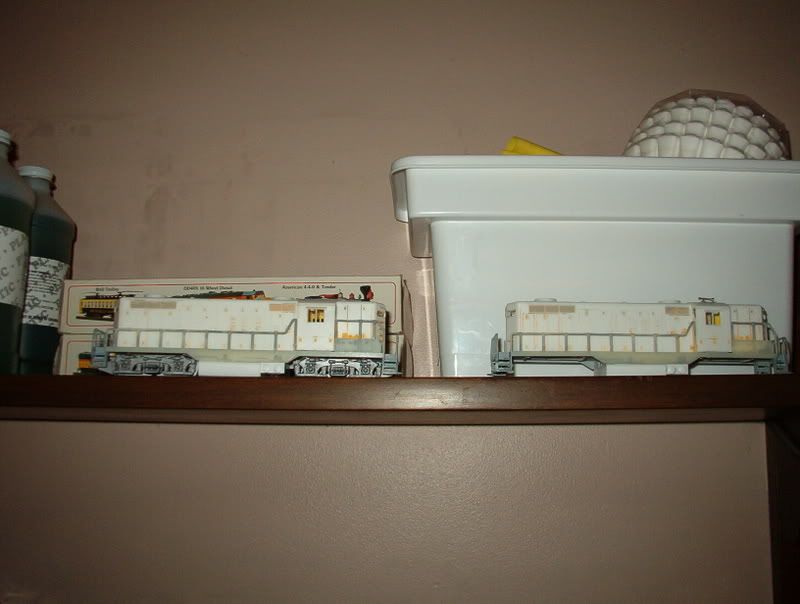

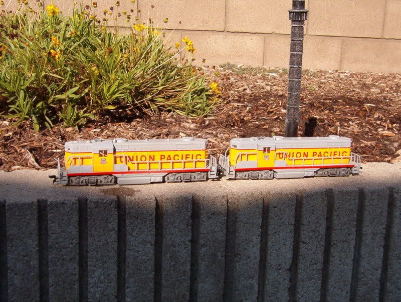

I’ve been talking all the time long about painting up some engines to MRL colors, so I thought that I would start by using some less impressive engines, or should I say less expensive engines to practice on. I spent this weekend removing the paint with Scalecoat II paint remover but after long hours of soaking and scrubbing, I’m still left with paint in the grooves. Question, what is the best technique to getting that paint removed? Here are my pictures:

Even with brake fluid, I see the same residue of paint in the louvers and corners similar to the second and third photos. Carefully digging or scraping the paint with an X-Acto knife works. It is easier if done when the model comes out of the brake fluid and the paint is softer. The paint gets hard again when it dries.
These two engines are made from Bachmann. I soaked them for about an hour or two, fully submurged and then took a tooth brush and warm water to rense them off. I them would soak them again to get what I missed. Maybe I didn’t soak long enough.
With using Scalecoat II the Bachmann bodies didn’t seem to have much of a problem. Never did they feel soft or weak.
Castrol Super Clean. I submerge the piece or a day or two and the paint washes off easily even from creveses. Does not hurt plastic and can be reused.
