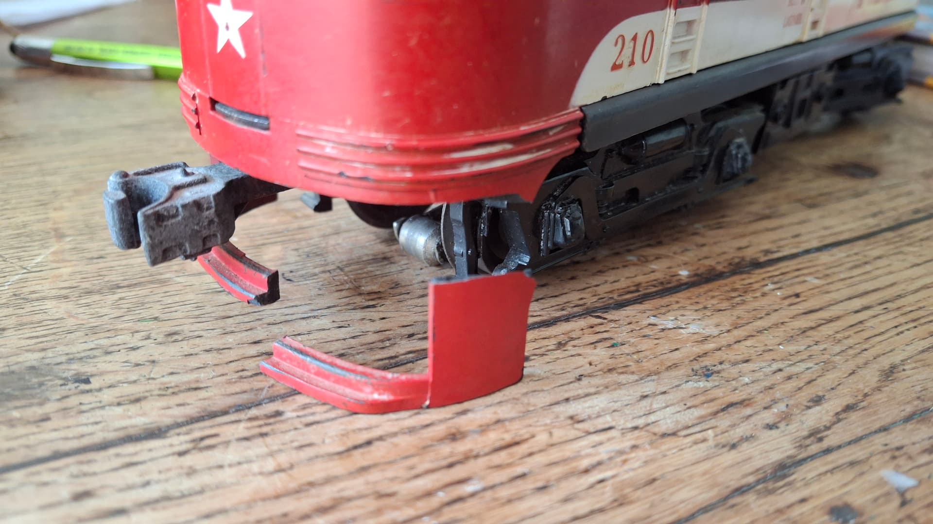

I recently received my dad’s old Lionel from when he was a kid, one of his locos was a 210 Texas Special Alco FA. After servicing it, it ran well, a little too well, and flew off the layout at the first curve (I really ought to do something to prevent that, its the second loco to do so), and the oh-so fragile pilot apron broke. I was wondering what kind of glue I should use to re-attach it, and I would like it to be unnoticeable (no glue globs, or sanding paint and repainting). Searcing the internet I only saw how to replace a missing apron, not fix one I still have, so I hope someone here can help.
Weld-On #16, thickened. It will even glue LGB stuff together.

I had to do pretty much this exact same operation on one of my B&M 217 ALCos. In my case, I used what was handy- super glue. I carefully applied just enough to make the joint, and tried to avoid that undesirable result of getting excess glue where I didn’t want it. The repair will break far easier than the solid, continuous piece of plastic it once was, but it did work and I’m okay with my results.
For a stronger solution, I would epoxy some reinforcement material onto the inside of the pilot where it will be largely unseen, but provide extra strength.
