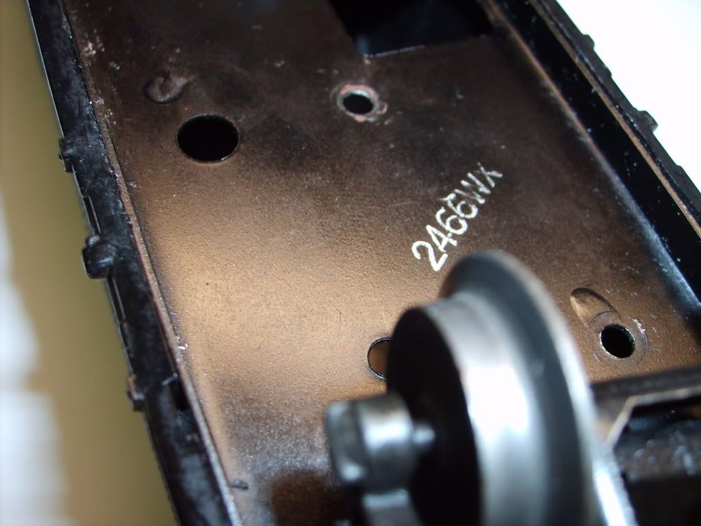

I have a Lionel 2466Wx tender with no whistle mechanism at all. It has one truck that has the center rail roller but no wire and no relay mechanism. What is the best way to get the whistle back? I’d be open to a new electronic unit, maybe with bell & chuff, but I want to have it under the “old” Lionel transformer control. Thanks for your suggestions and help.

Well, the tender is working now and the whistle is fine. I had installed the additional center rail pick-up (new part) and soldered the wires from the whistle mechanism (old but just acquired) to them. Nothing! After piddling around with it for a short while, everything went off to Jeff at Train Tender.
He said there was a bad gasket in the whistle which he replaced. Also the truck studs and e-clips where in need of replacement, which he did. I had noticed that the e-clips were probably on their last legs.
He found that some rivets holding on the back of the whistle body had been abused; he replaced them with tapped screws. You may be able to see what it looked like “before” in the above image.
He found one last problem. The ball bearing at the bottom (end?) of the motor shaft didn’t seem to be the correct size. That has been remedied too.
Jeff did so many things to improve the situation that I’m unsure what was a single problem or if it was the cumulative result of a lot of smaller things. Guess I’ll never know.
Everything arrived at the office today. At home, a quick set up of my oval gave the satisfaction of an air whistle which really works.
It took a little longer and cost a little more that I had originally thought but the results are just what you’d hope for.
