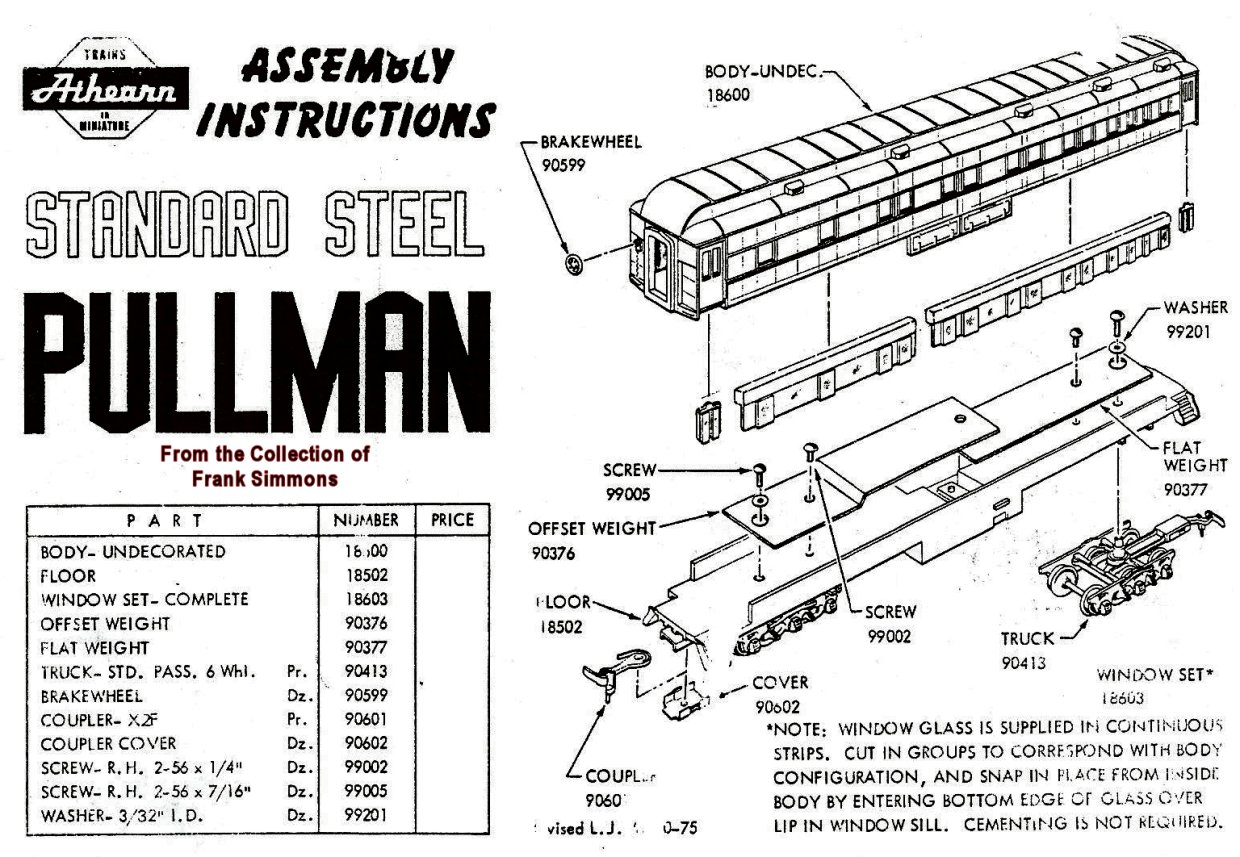

If you look at the instruction sheet for putting together the old Athearn standard pullman kit (easily found on the wonderful HO Seeker website):
http://hoseeker.net/athearninstructionscars1970/athearnstandardpullmancar1975.jpg
You’ll see how they are arranged – a strip of clear plastic with protruding segments that fit into the windows. Because they snapped in place as opposed to being glued or cemented, sometimes the window pieces just get loose and fall inside the car – I assume you checked inside your car to make sure they aren’t just sitting there? Note also the statement on the page that the window strips, part 18603 even back then, were supplied in continuous strips that the builder was to cut apart.
