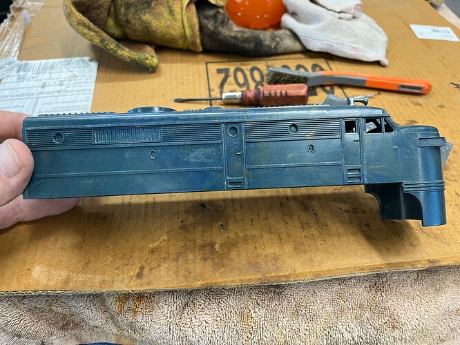

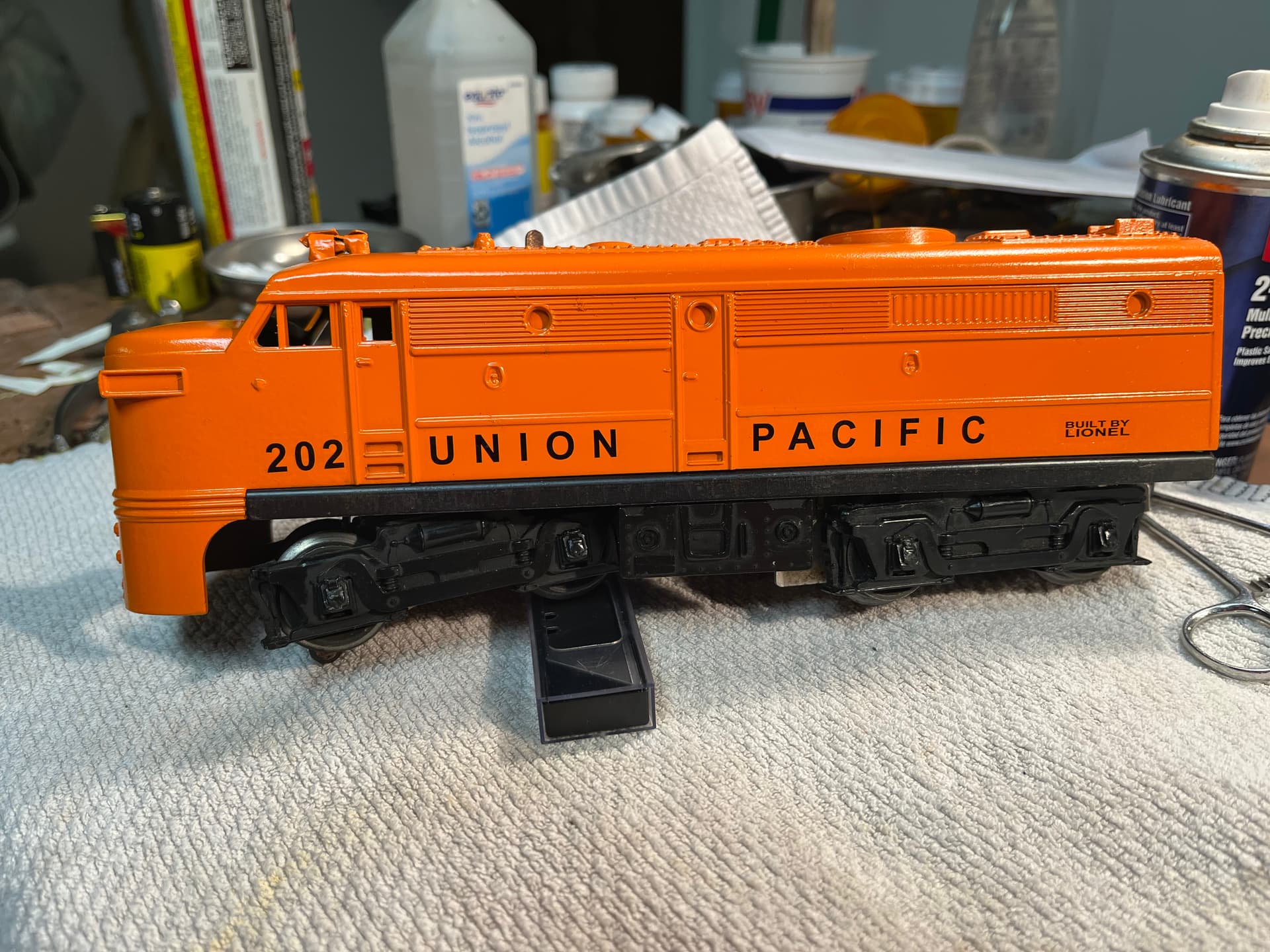

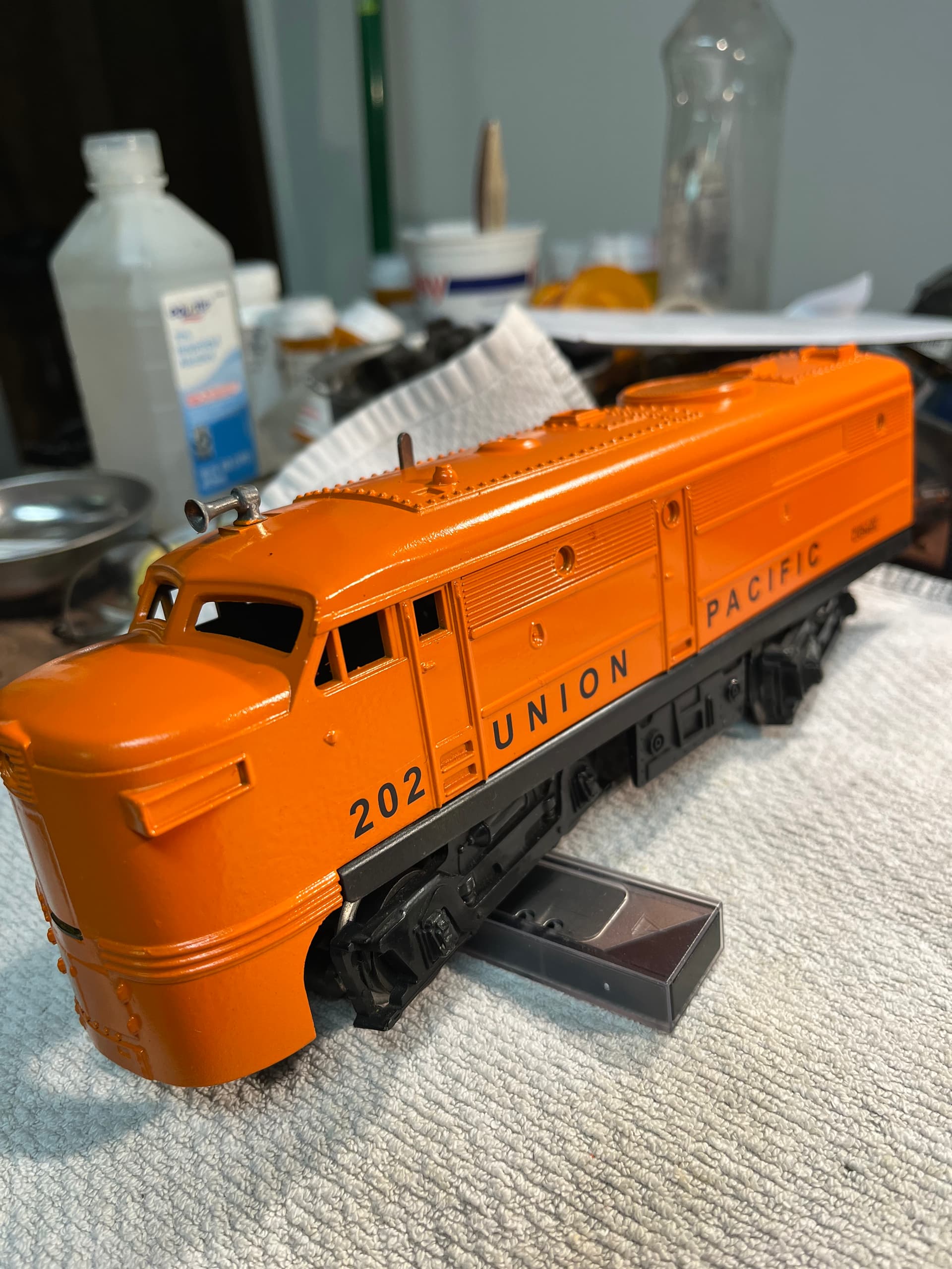

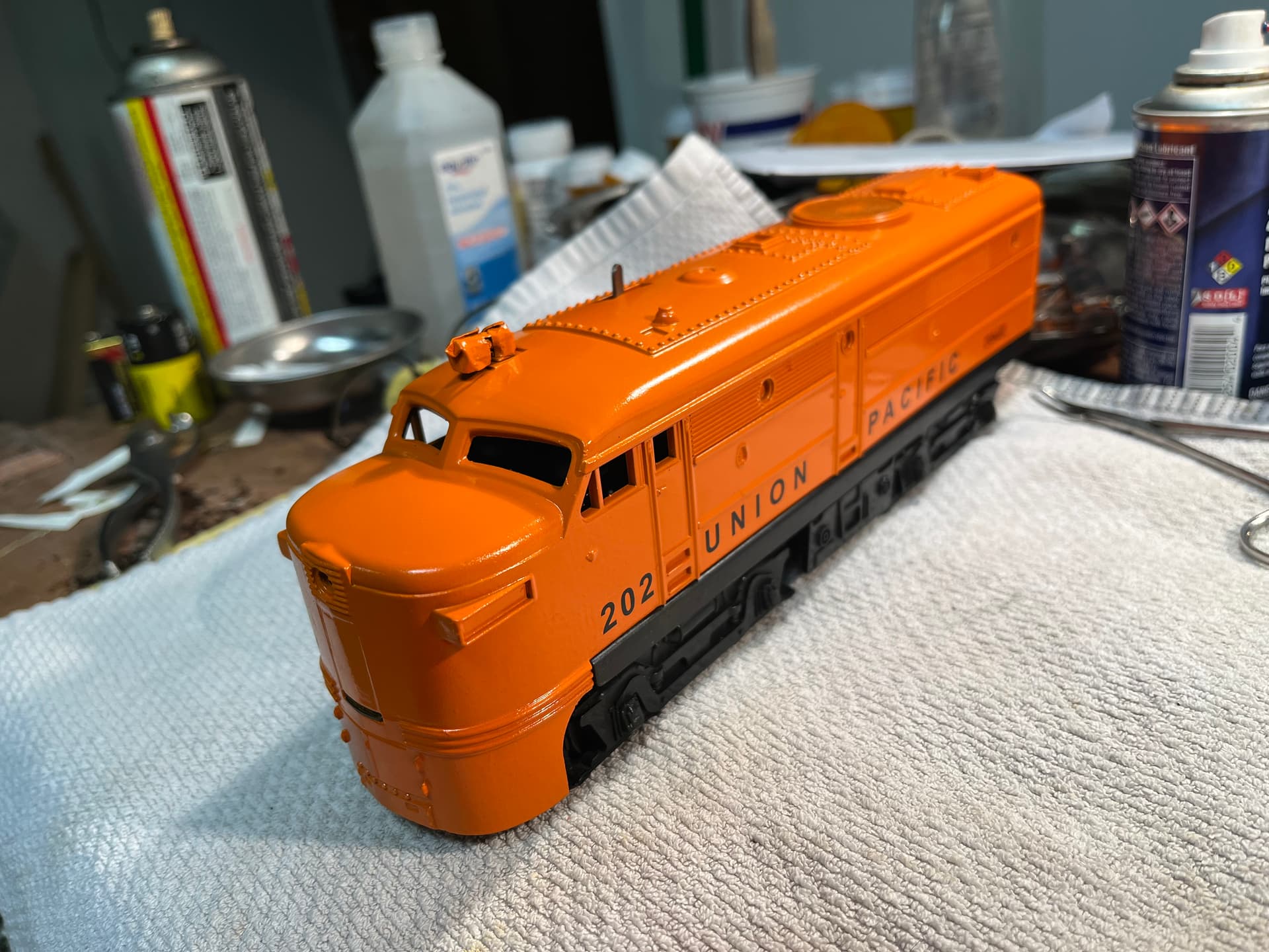

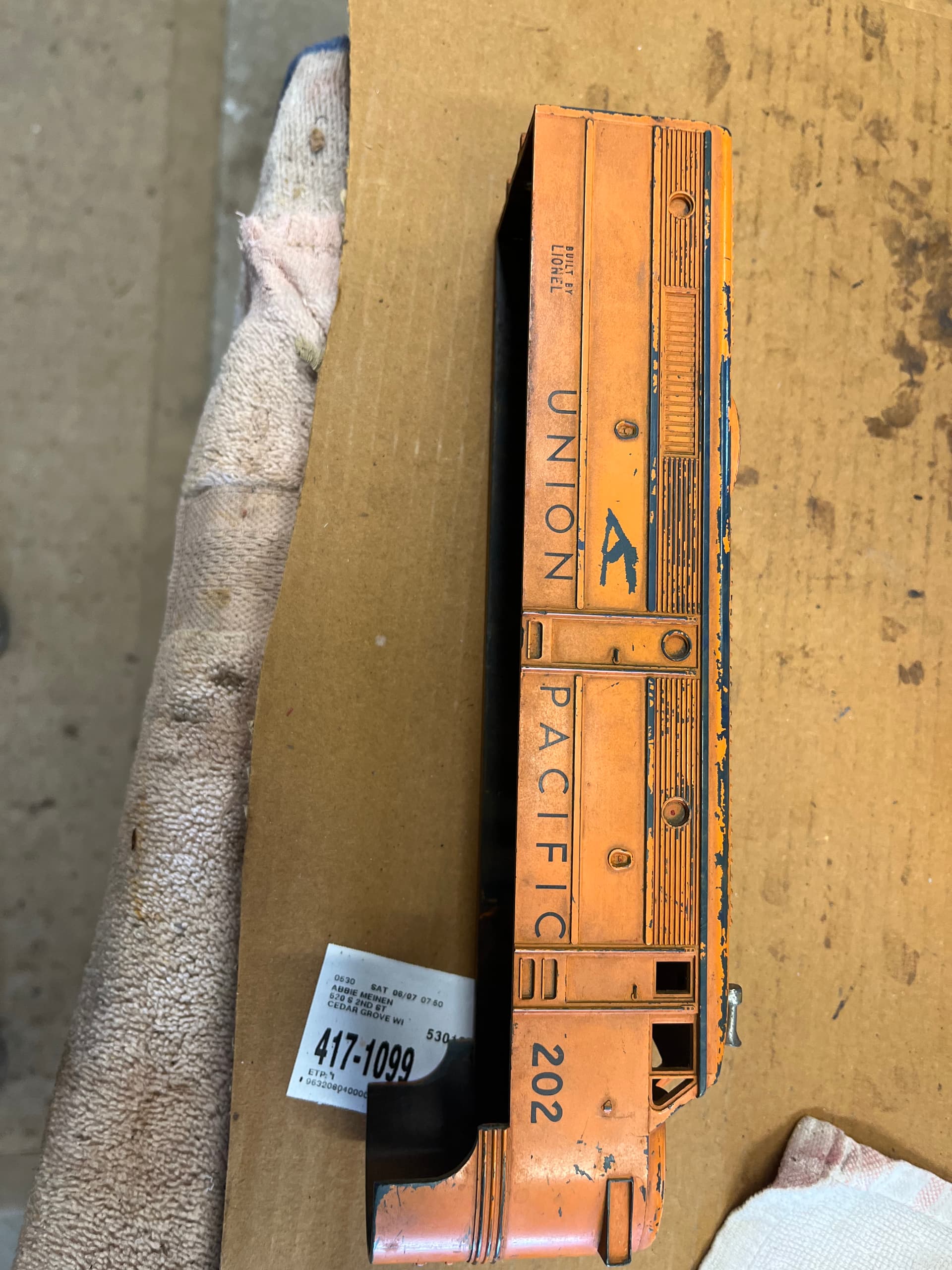

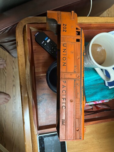

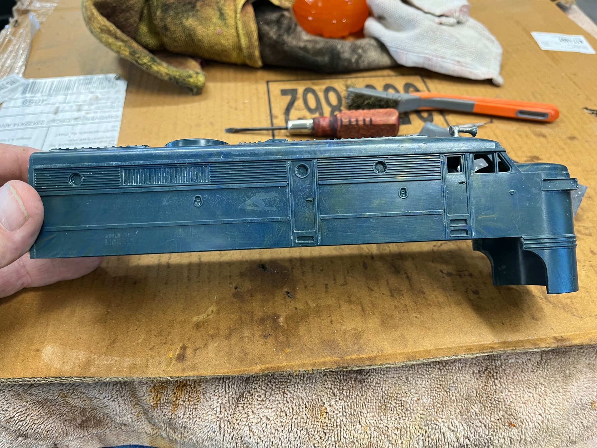

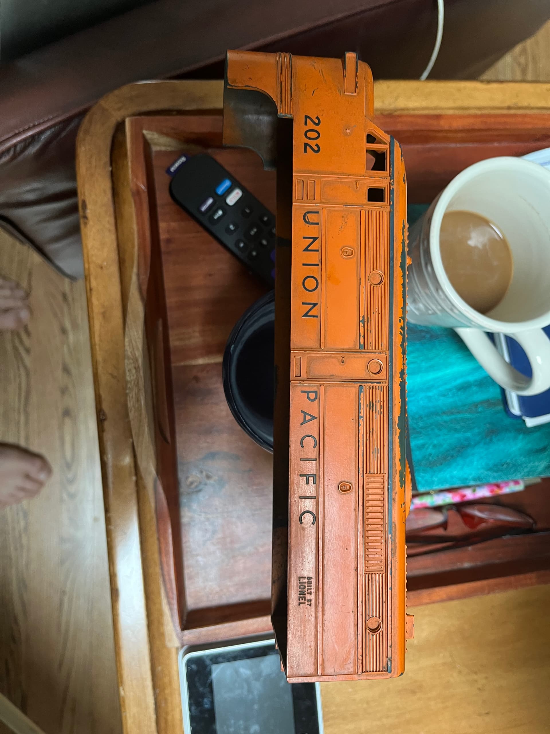

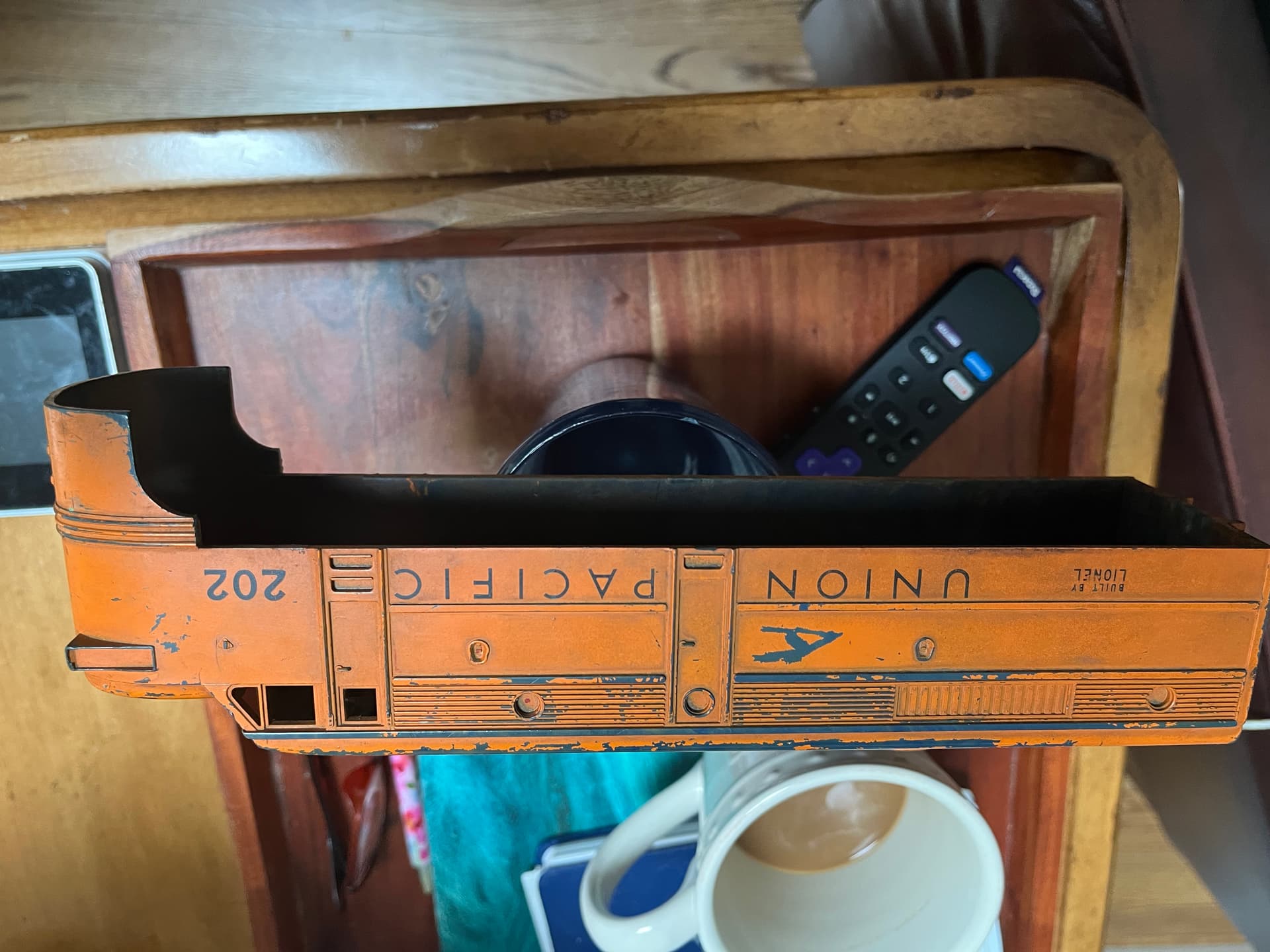

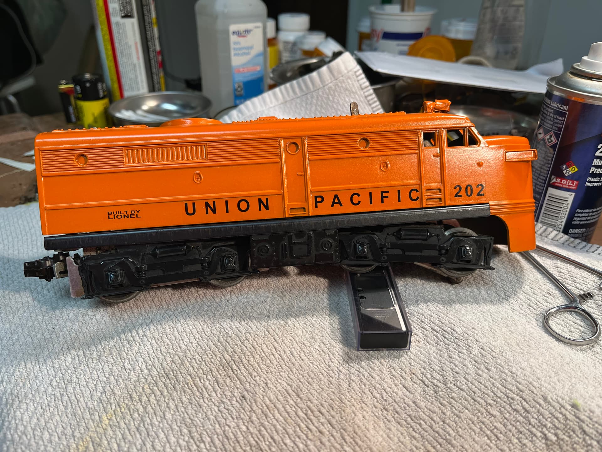

Thanks to all the members of this forum that guided me with information and their knowledge on how to strip and repaint my boyhood Lionel 202. I was rough on my first train and thought I would clean it up prior to my grandsons receiving it. After stripping it with Simple Green I primed it and found a Rustoleum Orange paint that I felt matched close to the original. Multiple coats later and letting it cure, I received the decals and applied them.
My only question is, if I apply a clear coat, which one have you found to be most realistic: Gloss, satin, or matte sheen. Thanks again for the help
Oh wow! She looks gorgeous! :heart_eyes: I’d go with satin, gloss would obscure the details and matte would make it look “cheap” in my opinion.
Outstanding! It looks BETTER than new!
I concur with Becky, I’d go with the satin (semi-gloss) finish. I don’t know that a matte finish would make it look cheap but a full gloss would make it look a little too toyish. in my opinion anyway. Semi-gloss is my usual go-to for a top coat.
