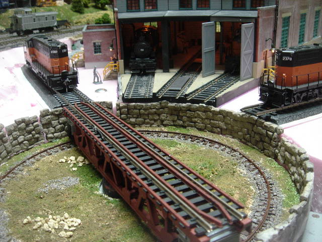

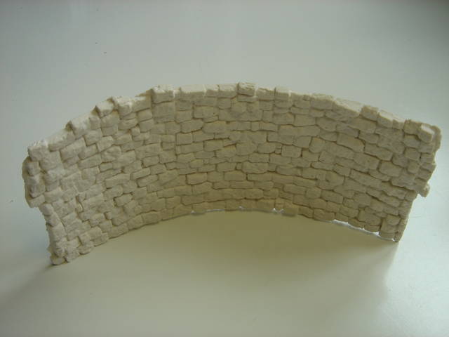

I have several stone wall molds from Dave Frary, at www.mrscenery.com. Unfortunately, the last time I looked, they were no longer in his catalog. He answers e-mails, though, and he may still have a few available. This is my favorite, which I cast in Hydrocal and then curved around a form before it hardened:
It came out like this, after I cut it down:
