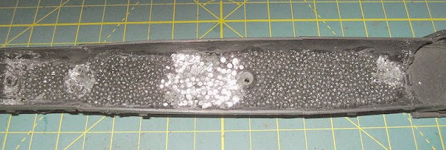

I don’t have an Allegheny but I have 20 Rivarossi articulateds and all of them have the slop you describe. The weight of the locomotive keeps the axles snug to the top of the driver assemblies. As a rule the Rivarossi locomotives are under weight so they don’t have a lot of traction.
I add 8 to 10 ounces of weight to the shells with #8 birdshot . . . . but not with the original Rivarossi motor.
I either use a pair of Canon EN22 motors or a single Faulhaber 2224RS motor. Finding Canon EN22 motors is difficult so I’m going with the Mabuchi SF-266SA motors. I have done a lot of testing of the SF266SA motors and I feel it is equivalent to the Canon EN22 at a lot lower cost.
