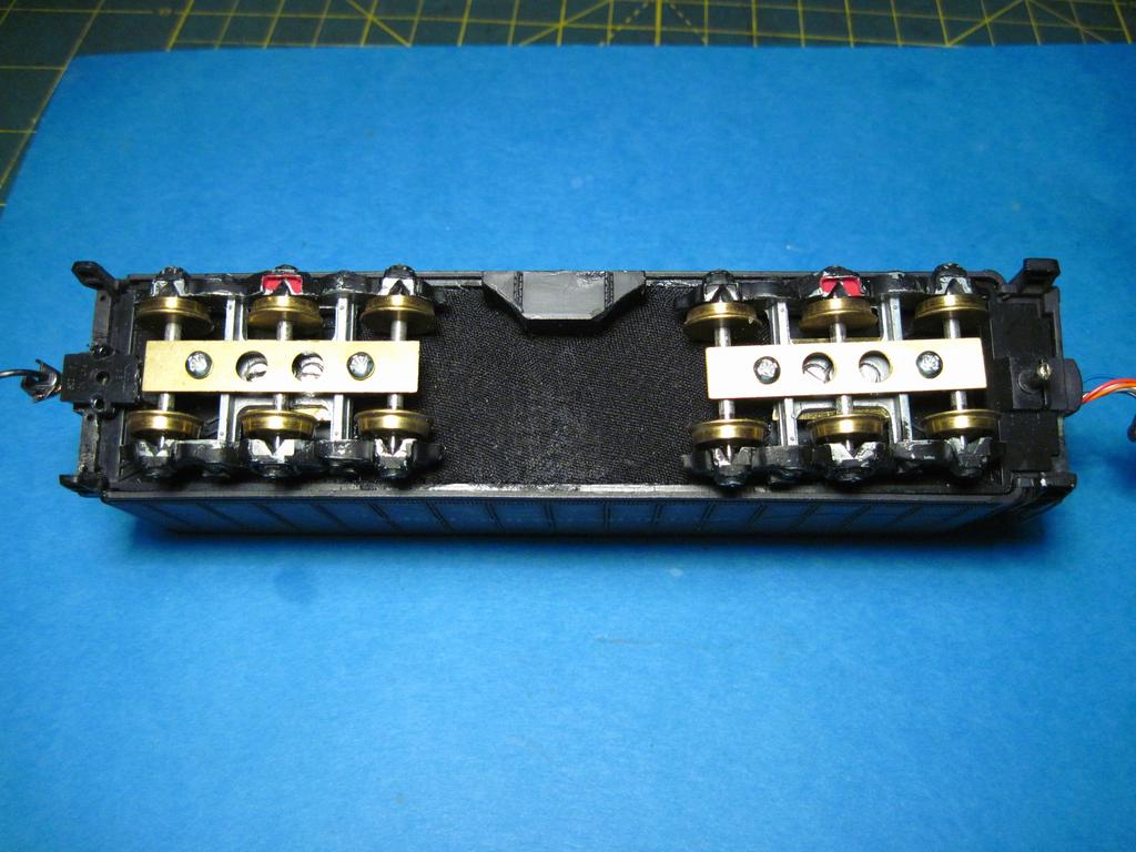

I might add that my two Cab Forward tenders with sound decoders don’t have Rivarossi trucks. The Rivarossi power pickup isn’t good enough for good DCC operation. The Rivarossi trucks use axle wipers on the two outside axles. I use a graphite lube on the axles to help electrical connection at the axle. The Rivarossi connection between the truck and frame is also pitiful. I solder a super flexible #28 wire from the wipers to the decoders.
The Rivarossi truck frames with the JB wheels do very good for straight DC operation.
I prefer using Bowser #35107 Buckeye Trucks on my Rivarossi oil tenders with decoders, very good power pickup and track great, never derail. Kinda hard to find since Bowser discontinued them.
