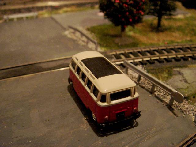

On some roads, particularly those with steep dropoffs, I like to use Pikestuff guardrails. I combine them with some WS fine ballast, applied just like on the tracks, to form a gravel shoulder with a guardrail. Sorry, this isn’t a great picture, but the camera’s out of town right now.
One package of Pikestuff guardrails makes about 7 inches. It comes in 4 sections, with different kinds of end plates. I found that I didn’t have enough vertical supports, but the ones I had were twice as high as I needed, so I cut them in half and then had enough. For mine, I glued the pieces together with CA and then sprayed them with rattle-can silver paint, and followed up with some Dul-Coat.

I like to use fine ballast to simulate gravel along the edge of the paved surface.
Once the road surface is in place and painted, I put the ballast down and then wet it with alcohol. I mix my glue with equal parts water and alcohol, it flows better then just water and glue mixed, and it dries rock hard.
